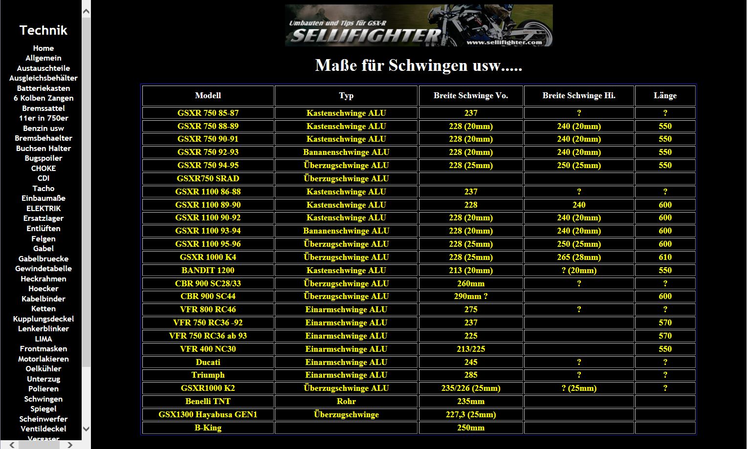

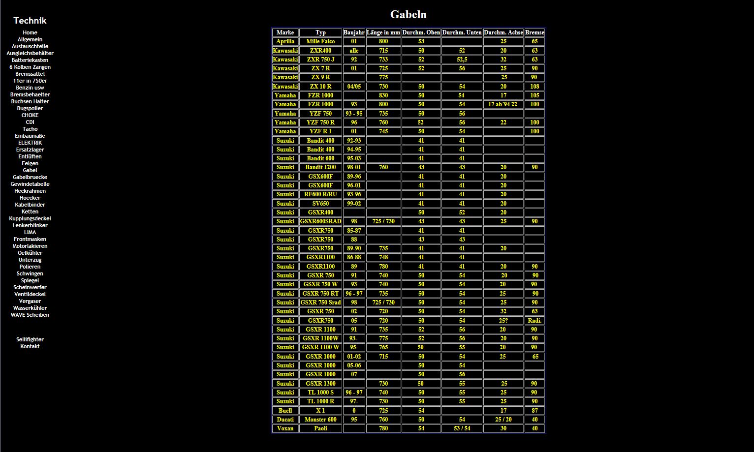

This manual and hours of reading here in this great forum helps me a lot on my project bike fork swap.
I used a ZX9-R fork with 780 mm length
