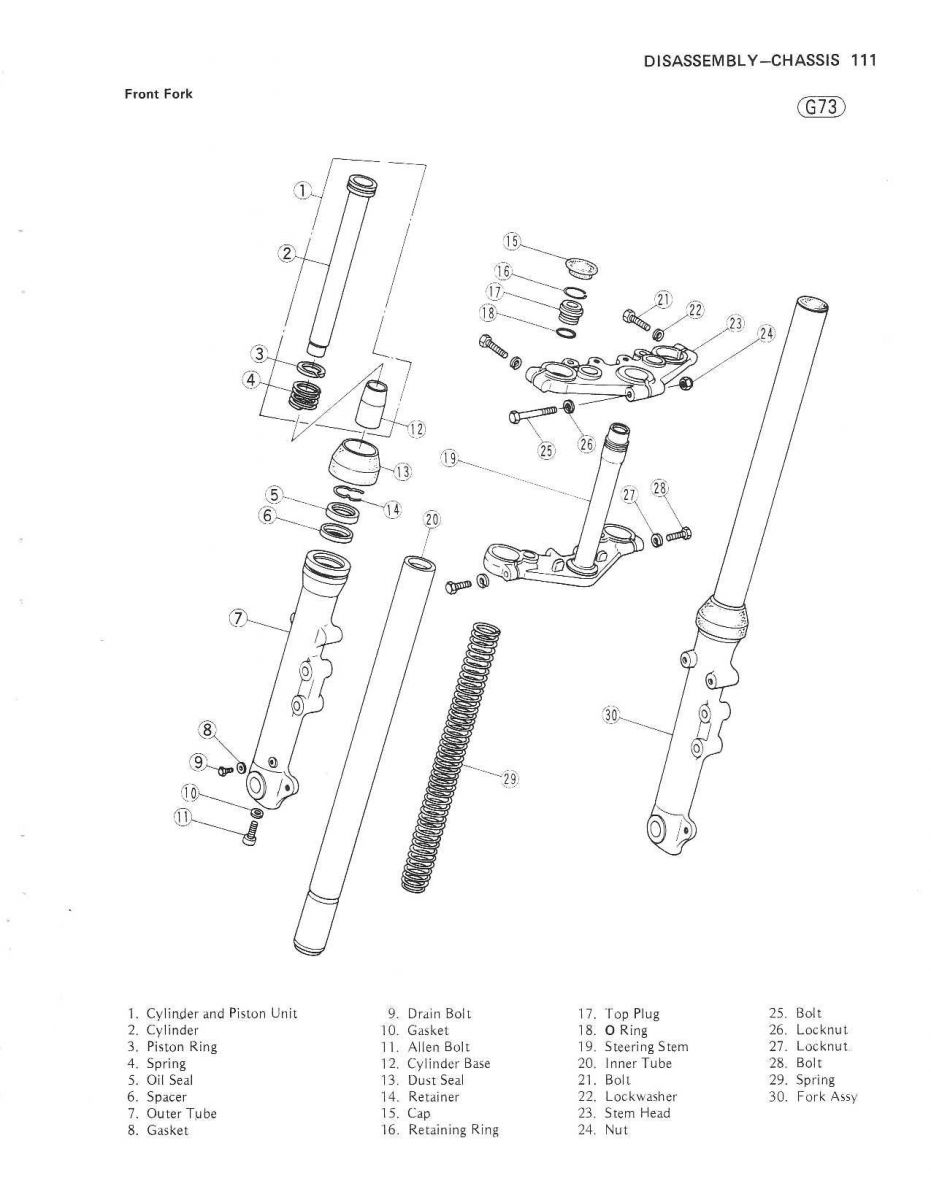

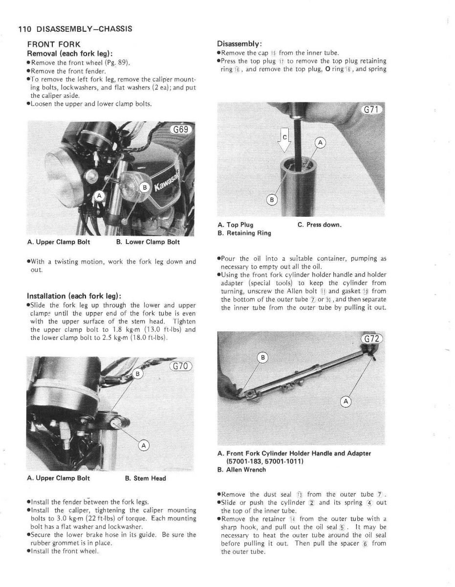

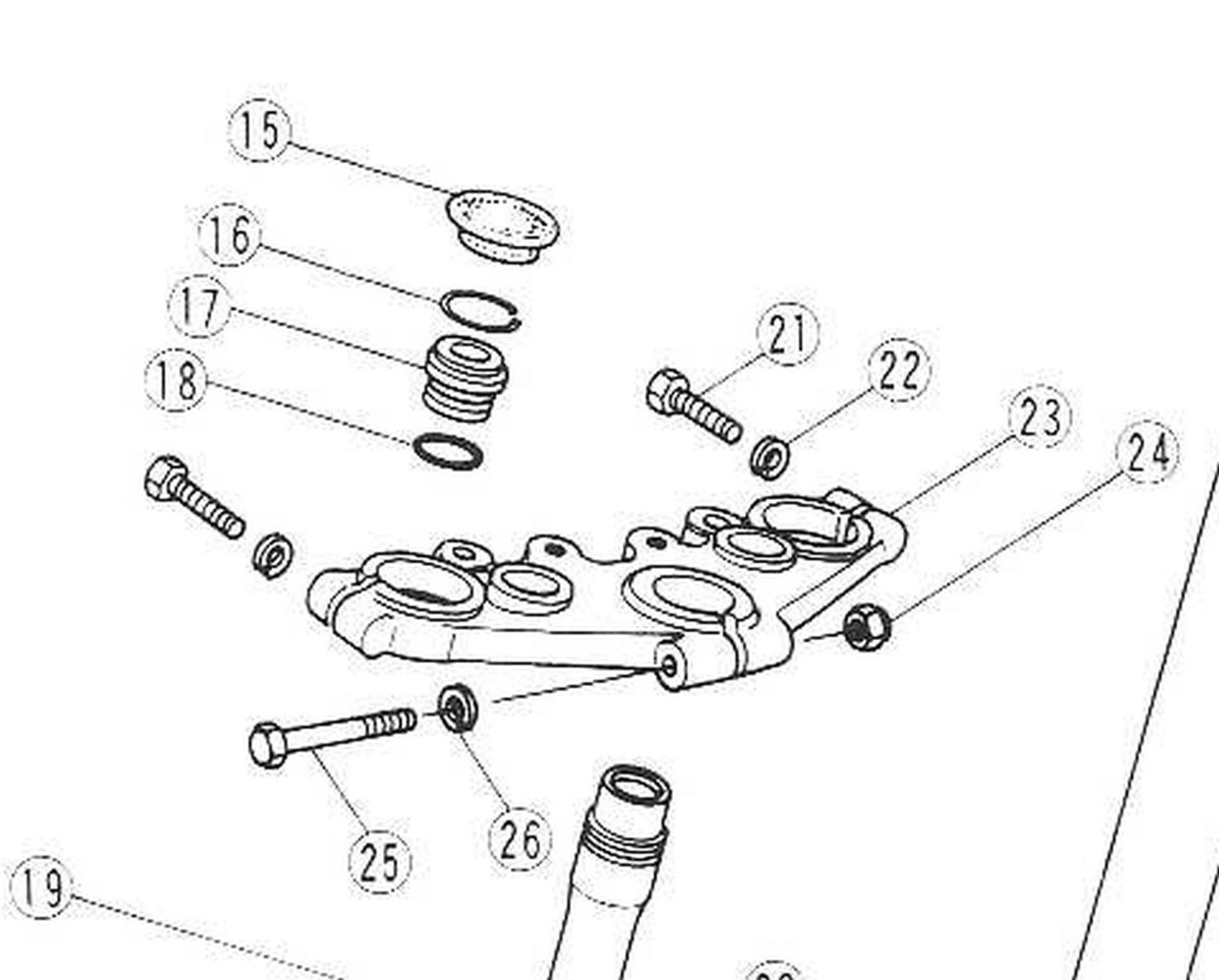

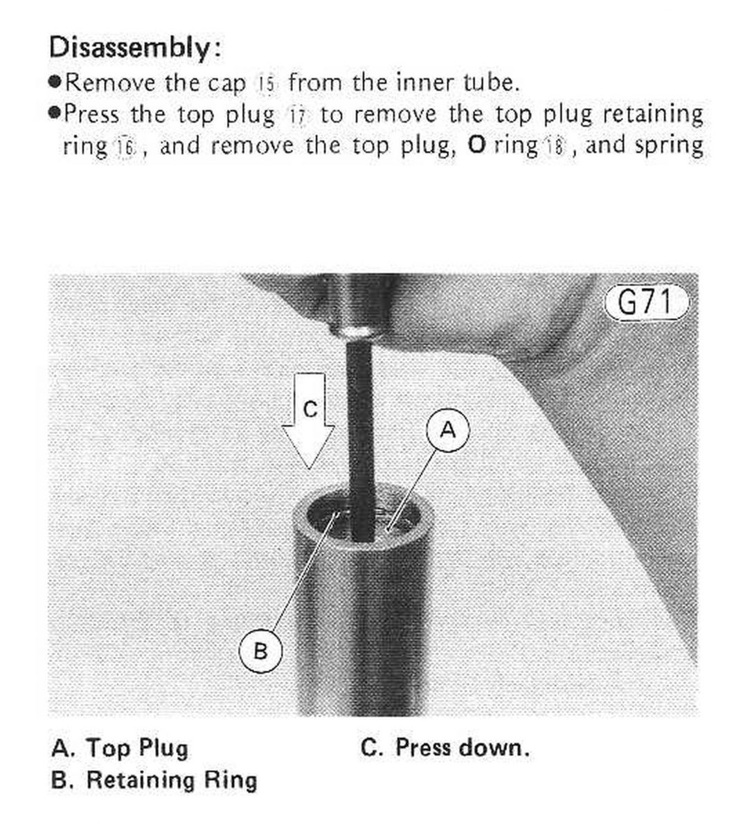

You have to remove the criclip to get the plug out.
Get the service manual here
jpavlov.wordpress.com/files/2009/10/kawa...2_service_manual.pdf
Michael
Michael

You are making a HUGE mistake trying to work on the bike without using the Kawasaki Service Manual. Don't do it; you will cause more harm than good! If you currently don't have the funds to buy a manual use the one at the link below until you do. Ed
www.kzrider.com/modules/ServiceManuals/K...0KZ250%20-%20305.pdf

When removing the circlip, keep in mind that the plug is under spring pressure & can go flying.
Before removing the circlip & plug, if it's all dirty, crusty & rusted, I would saturate it with a penetrant & let it sit overnight or longer, then clean it up some, then remove the clip. I use liquid wrench penetrating spray lubricant.
