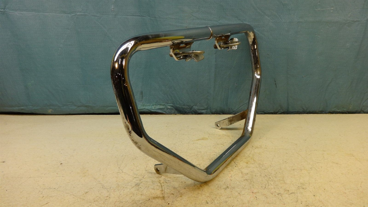

Been looking for crash and highway bars for my bike for a couple of years now and finally found and bought them. They're supposed to arrive tomorrow. The seller pulled them off another '82 750LTD, so they should fit with no modification, right?
I was wondering if anyone can draw circles on a photo showing where it attaches?
Here's the bars in question:
I'm pretty sure they attach here, but it seems like that's only half of it... and I could be wrong about any of it.

I'd say it's the single bolt below the circle.

04 Jun 2017 16:15SWest wrote: I'd say it's the single bolt below the circle.
Yeah, on further inspection I thought the same... but what about the top brackets? I can't identify where they bolt into.

The top ones bolt on to the front frame.

U bolts around the frame.

So the top ones are clamps then? That makes sense, looking at the photos.
