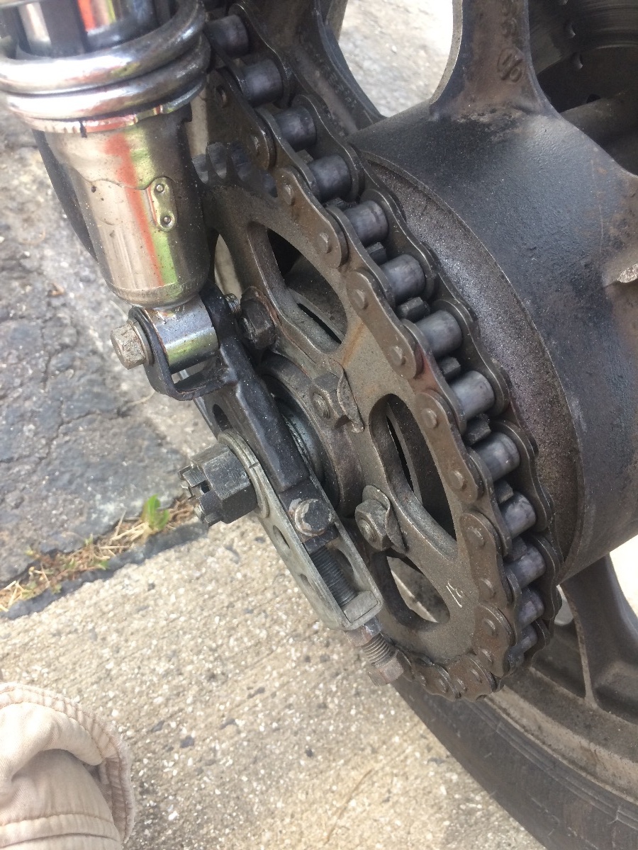

My rear wheel assembly is put together correctly. I used a shop manual. My rear sprocket is a 38t. 630 chain. Stock rear shocks. Chain hits the shock slightly. Ive tried tightening the chain, loosening the chain. Its in soec right now. What is my problem? Is the sprocket to big? The sprocket is not stock i dont believe.

You may need to post a photo or two.

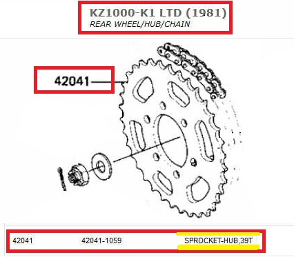

In the diagrams at Partzilla for the 1981 KZ1000-K1 Ltd, the stock rear sprocket is 39T.

Since it was in pieces, you can't really be sure if everything is stock. Using the diagrams at partzilla & eebbaayy photos, I would check to see exactly what each part should look like, preferably pics of nos parts. I would also compare the diagram in the manual with partzilla to make certain everything was assembled correctly. maybe a wrong part is mixed in or it was assembled incorrectly. Other than that, I have no idea, but this is one of those cases in which a photo might be helpful.

Re: Chain/shock problem
03 Jun 2017 16:02
It only goes together one way correctly so im confused on if im missing a washer or if my shocks need to be switched out to something thinner

I suspect it's the spacers in the wheel. There's not enough threads showing in the castle nut.

The sprocket doesn't look right to my eye. There appears to be a gap between the sprocket carrier & sprocket. I think the sprocket should be flush up against the carrier. The manual has a pic which also shows that there is a spacer visible against the chain adjuster. pg 2-15.
I'm not familiar with the KZ1000 K Ltd, so I could be wrong.
Keep in mind that the bike was in boxes, so who knows whether or not everything is correct.

I have a couple observations –

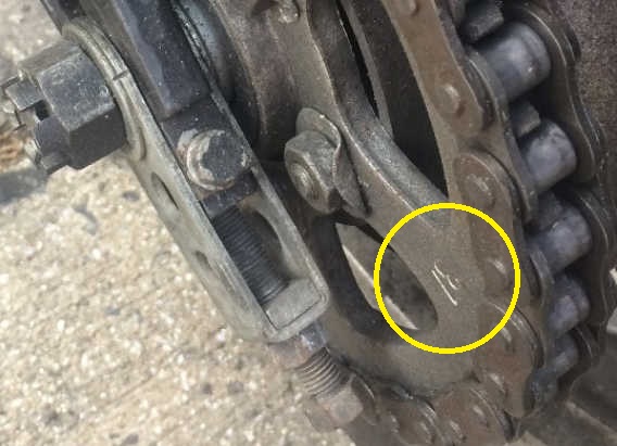

You state “My rear sprocket is a 38t. 630 chain.” The stock sprocket had 39 teeth (see 1st image below). The sprocket in the photo you provided appears to be marked for 37 teeth (see 2nd image below). This may at least partially explain why the chain adjusters are set so far out.

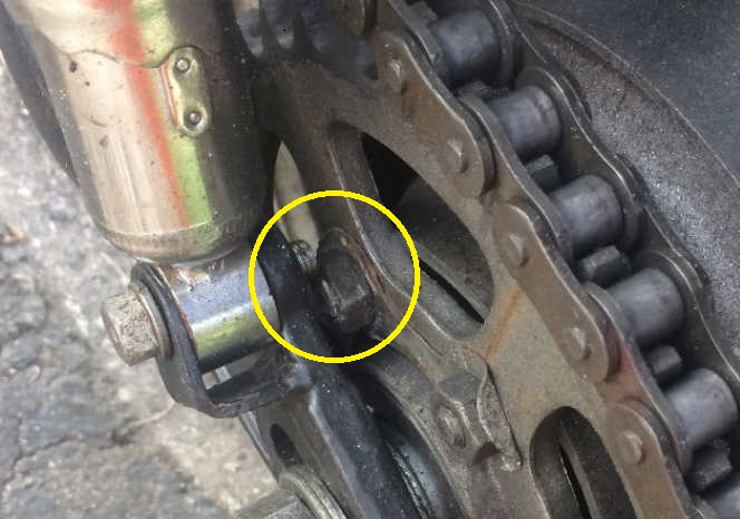

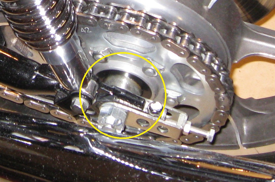

However, installing the larger 39 tooth sprocket would likely cause the chain to contact the shocks even more. That makes me believe that a spacer may be turned the wrong way around or installed in the wrong spot. Also, notice in the 3rd image below the sprocket nuts are running way too close to the lower shock mount bolt. The 4th image below shows the spacer on my KZ650-C1. You can see there is a bit more of it between the sprocket and swing arm than on your bike.

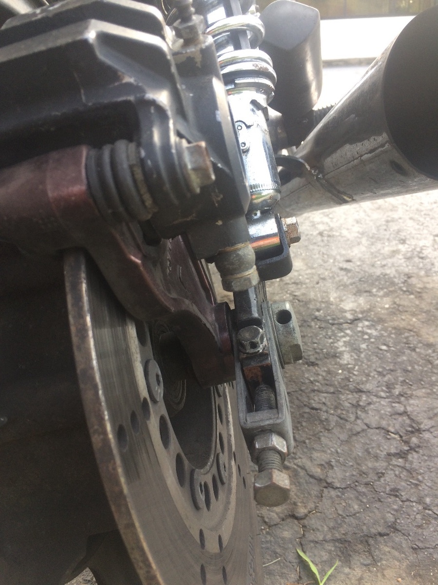

What I don’t understand is this – if you were to change the spacers, theoretically correcting them, such that the sprocket and wheel moved a bit toward the right side of the bike it would seem to me that the brake rotor might then come in contact with the brake caliper. Can you tell if the rotor currently is centered inside the caliper? Ed

I suspect it takes a 15-35 set of sprockets.
