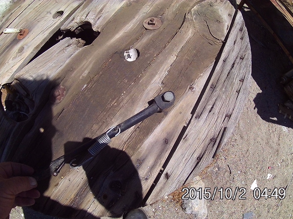

25 May 2017 13:55
Mine is 40 years old. I've tightened it and it lasts a while until it gets loose again. I tried to straighten it without heating it up. That little voice again and broke it. I welded it, it works but I need a new one. I want a chrome one this time. I saw nothing cheap about the Kaw stand. Pic of yours?
