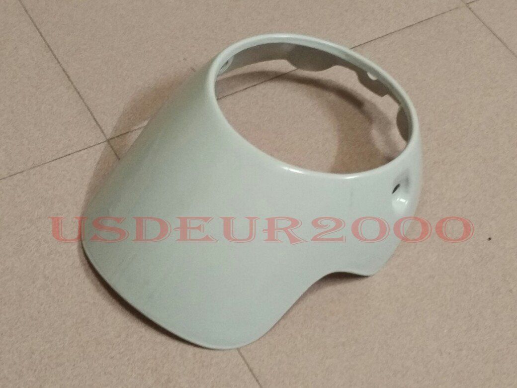

This one from "China" is less expensive made of ABS plastic and has clearance slots at the botton of the fairing to gain access to the headlight ring.
I think the Chinese one would be a better fit. What do you guys think ???

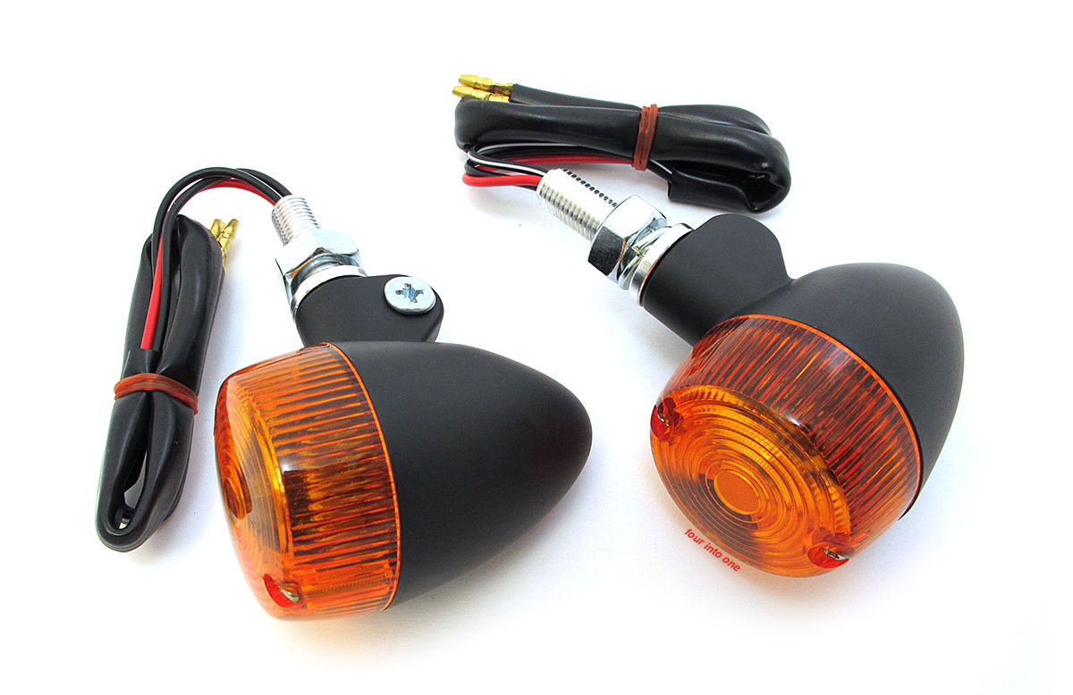

I appreciate you responding to my Post. I would love to install the Maier Sport Fairing but with the short stalk mini turn signals that I have installed thru the headlight ears, they're too "short" ( 2 3/4" from mounting surface to outside of signal ). The Maier fairing measures 12" across at the cut-outs. That 12" wide cut-out would put that right in the middle of my turn signal lens.
Even threading a 1/2" nut on the mounting stem of the signal to the end which buts up to the headlight ear only gives me very little threads to capture. End up using a narrow jam nut to mount. That moved the signal out a 1/2" but still sits inside the cut-out of the fairing. So that's where I am at now.
Anybody else care to respond with any other ideas besides changing out my signal to a "longer" one.

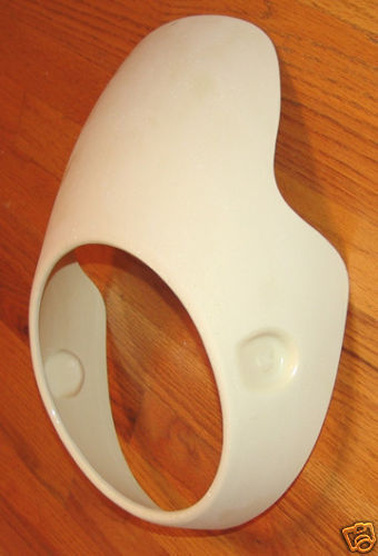

Could you Post a Picture of the Flyscreen you're talking about ?
