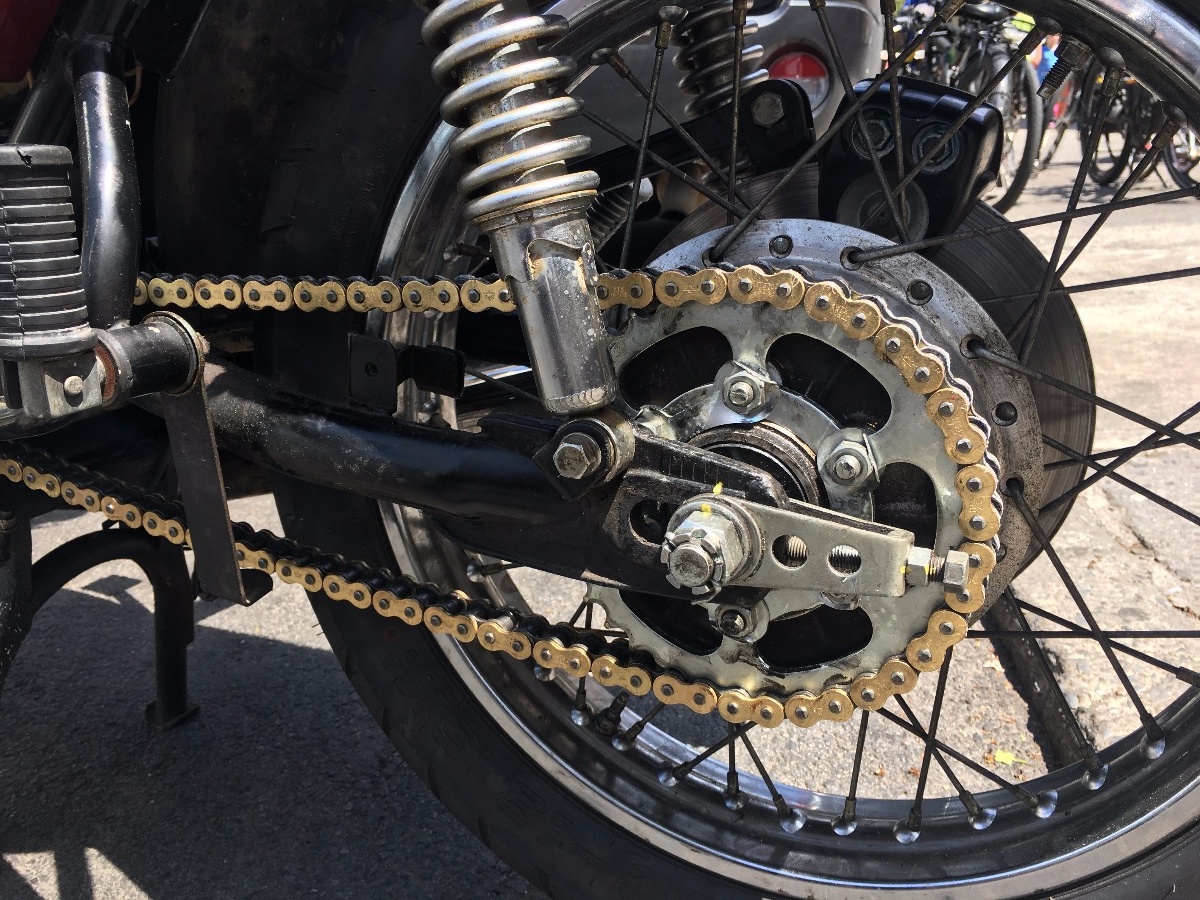

My son (baby) tore my manual to shreds and I currently have a 530 106 chain on my bike which seems to damn long (forgive me, Im annoyed).
Does anyone know how many links the stock chain has on it, and what is the CORRECT sprocket set up on a 77 KZ750 Twin. Thanks!
This is the bike with the new chain and sprocket. Since the wheel is all the way back, its clear there are too many links. Im annoyed.

Master link? Take one out and see how it is.

A little internet checking indicates that stock is:
16 Tooth Front Sprocket
38 Tooth Rear Sprocket
530 Pitch 100 Links Chain
If not already done, would count teeth on existing sprockets.
