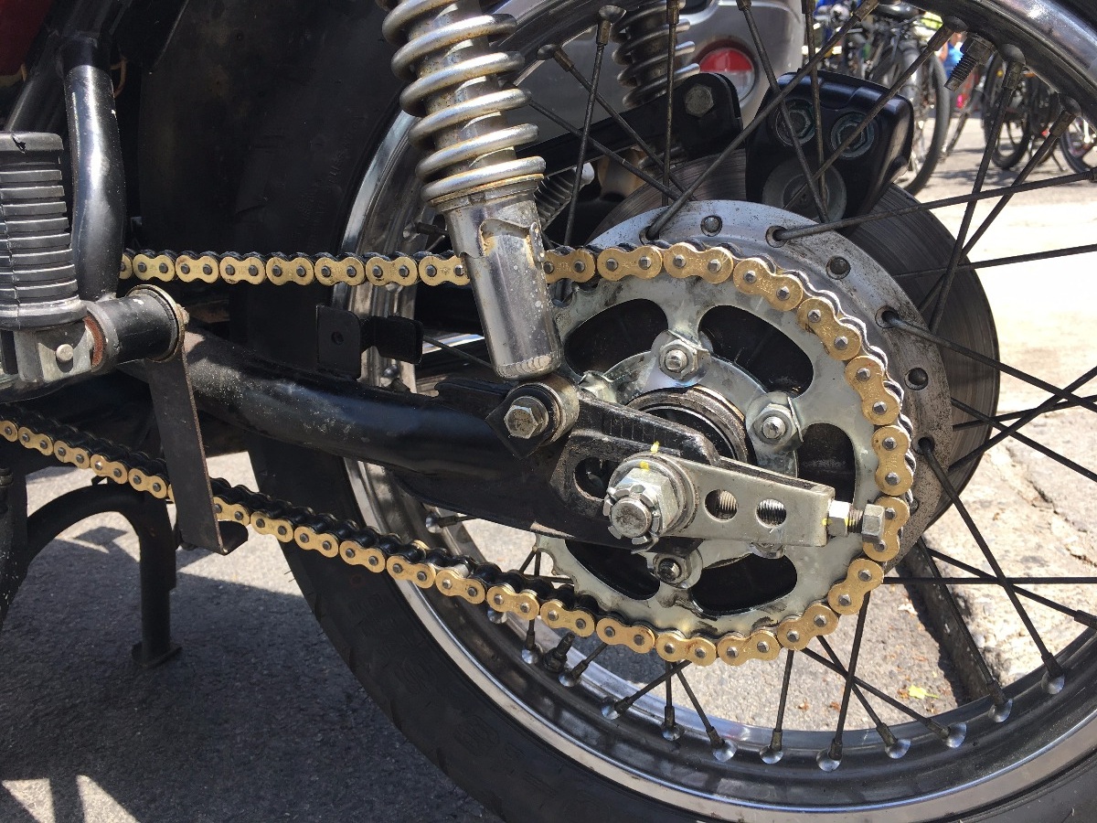

Going through Downtown Manhattan, NYC to cross over into Brooklyn via the Williamsburg Bridge, my chain broke while I was doing 20MPH. I was lucky. Not a scratch on me or on the bike.

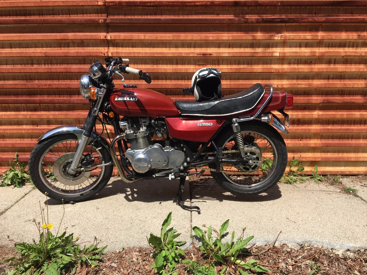

Went scrounging online for parts and got a JT Sprocket and chain. As of today Im back on the road and the bike runs great. It was 85 degrees F today, or about 29C and i had a great ride. Here is a photo of the bike. I took it today before I went riding.

That chain adjuster is adjusted nearly all the way toward the outer end of the swing arm. Normally, it would be nearly all the way forward, especially with a new chain. Are you sure the chain has the correct number of links? Ed

30 Apr 2017 04:56 - 30 Apr 2017 05:06Im going to count them today. There should be 106. It could be 110. If it turns out its 110, what are the repercussions of running it as is, with 4 extra links?

You don't have much adjustment to compensate for chain stretch.

If you are going to take out links do it now. Does it have a master link? If so move the wheel all the way forward, disconnect the link and see if it will fit the next link without cutting it. One tooth larger countershaft sprocket will give you more adjustment room if you can't take out a link. Same with a larger rear sprocket.

30 Apr 2017 07:35SWest wrote: If you are going to take out links do it now. Does it have a master link? If so move the wheel all the way forward, disconnect the link and see if it will fit the next link without cutting it. One tooth larger countershaft sprocket will give you more adjustment room if you can't take out a link. Same with a larger rear sprocket.
Yes it has a riveted master link. I suppose i can take that off. BUT will i have to take the covers off and whatnot or can i do it while the chain is still on the bike (take the link out I mean)

30 Apr 2017 14:36 - 30 Apr 2017 14:37SWest wrote: If you are going to take out links do it now. Does it have a master link? If so move the wheel all the way forward, disconnect the link and see if it will fit the next link without cutting it. One tooth larger countershaft sprocket will give you more adjustment room if you can't take out a link. Same with a larger rear sprocket.
I counted the links on the chain as its on the bike. Its OEM spec 106 links. I wonder why it "seems" longer. Hmmmm.
