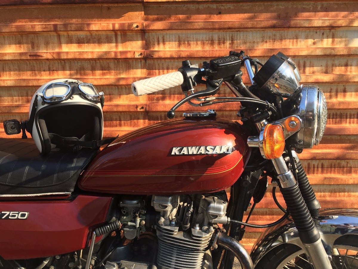

Here is my bike. Im considering a fairing either painted white or the color of the bike. Any ideas? I havent seen to many with fairings, and only with those not-too-attractive-to-me EMGO black universal fairings.

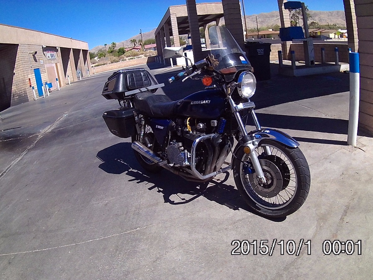

I like mine, it's not too big and shields me from the wind. Have a lot of it out here and I can go 80+ without having to tuck in.

I think yours is fine but im looking for something a little more cutting edge and cafe-racer ish.

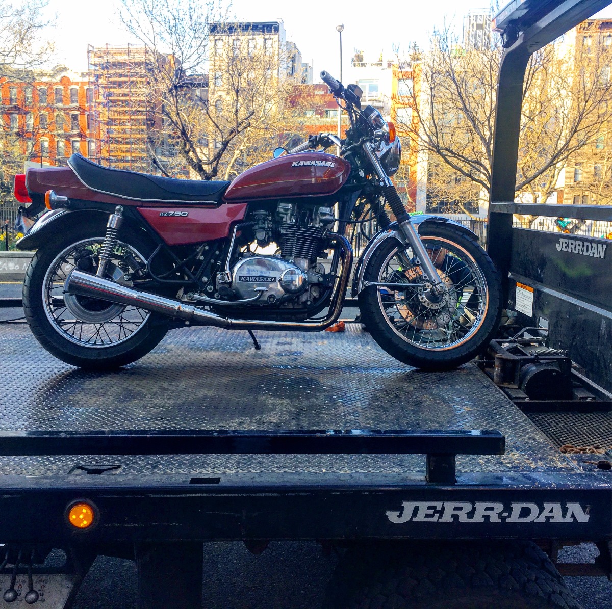

btw im still not back on the road after the chain snapped. Im awaiting parts. Man that was scary. Thankfully i was only going 15mph. I found out the previous owner DID in fact use half link in the chain, and that the torque of the 750 is WAY to much for anything but an endless OEM chain or riveted masterlink. Here she is on the tow truck an hour after it happened.
