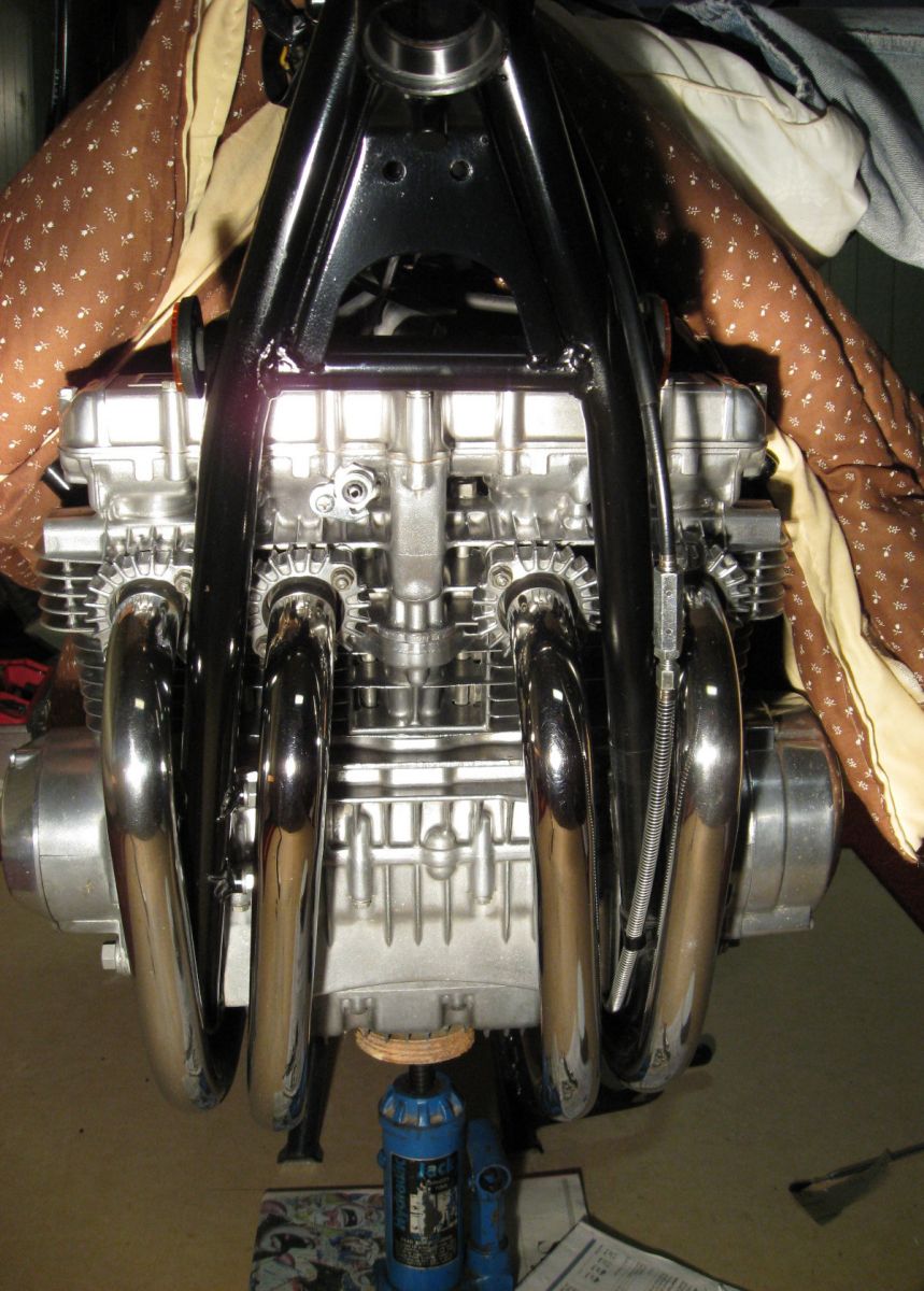

Here's how I did mine several years ago:
To do this work I had to remove the front forks. I did the work in my basement during the winter. I laid a 4’ x 8’ sheet of 7/8” hardboard on the floor and parked the bike on it. This was to protect the basement carpet from possible stains, and it also enabled me to very securely anchor the rear of the bike while the front forks were removed. With the bike on the center stand, I put a small bottle jack under the front of the engine with a piece of wood between the jack piston and the oil pan to protect the oil pan (image below). I jacked up the front of the bike until the rear wheel came in contact with the hardboard. Then I ran a cargo strap through the swing arm, attached the “S” hooks on the ends of the strap to the edge of the hardboard, and took the slack out of the strap. That strap made the bike very secure. You may want to use this same method if you remove your forks.
