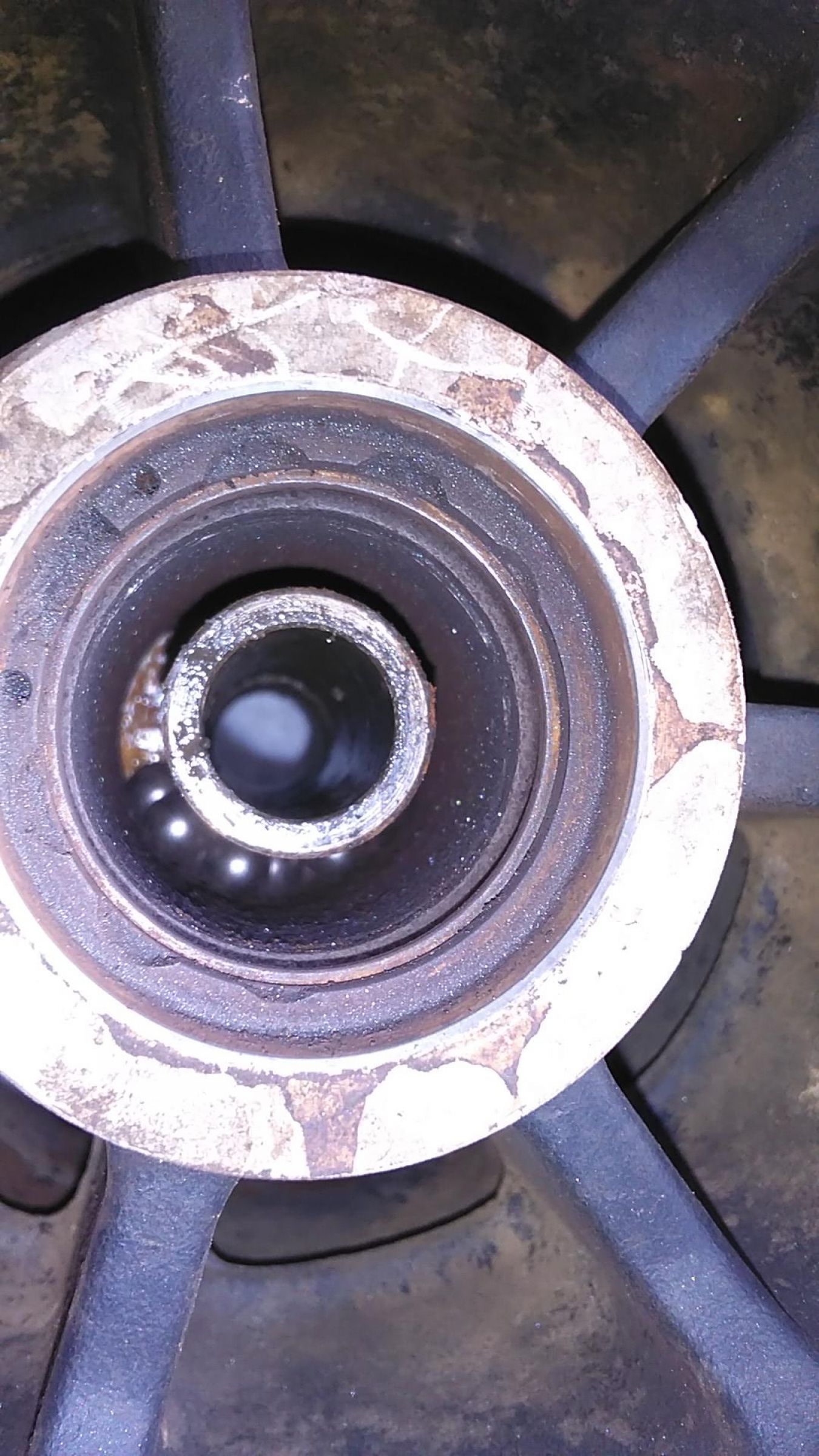

Want to see just how much of a freaking idiot I've been about these bearings? Keep in mind, I know better now, so please don't yell at me, because it's not only fixed, but I'm never letting it get anywhere near this point again... I'm posting these images more as a warning for other potentially negligent morons out there to see why you should take this kind of thing seriously.
The seal of the right side bearing hanging off the axle.
Inside the hub viewed from the right side, the right side bearings had fallen out and were all over the inside of the hub.
Left side was in better condition, if just super f'n grimey, but you can still see the seal on the bearing has gone to hell and isn't long for the world.
Don't be like me. Don't ride on a wheel until you can feel it wobbling while riding it. I'm lucky I didn't face plant. Check your bearings often.

I would urge you to thoroughly check all the other mechanical bits that can get you killed before riding that bike again. If those bearings were so sorely neglected it's a cinch that other parts were not maintained properly. Ed
