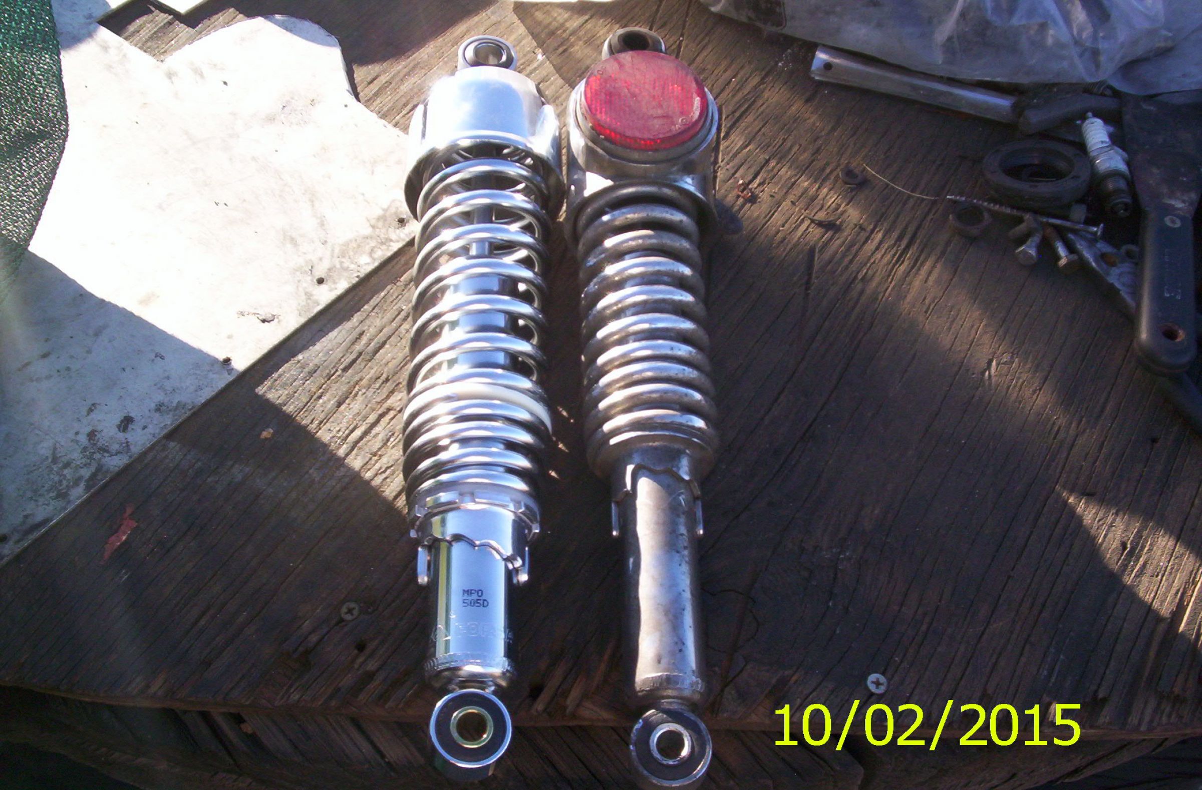

I want to remove the spring to have it rechromed. Wondering if anyone has done this and can let me how.

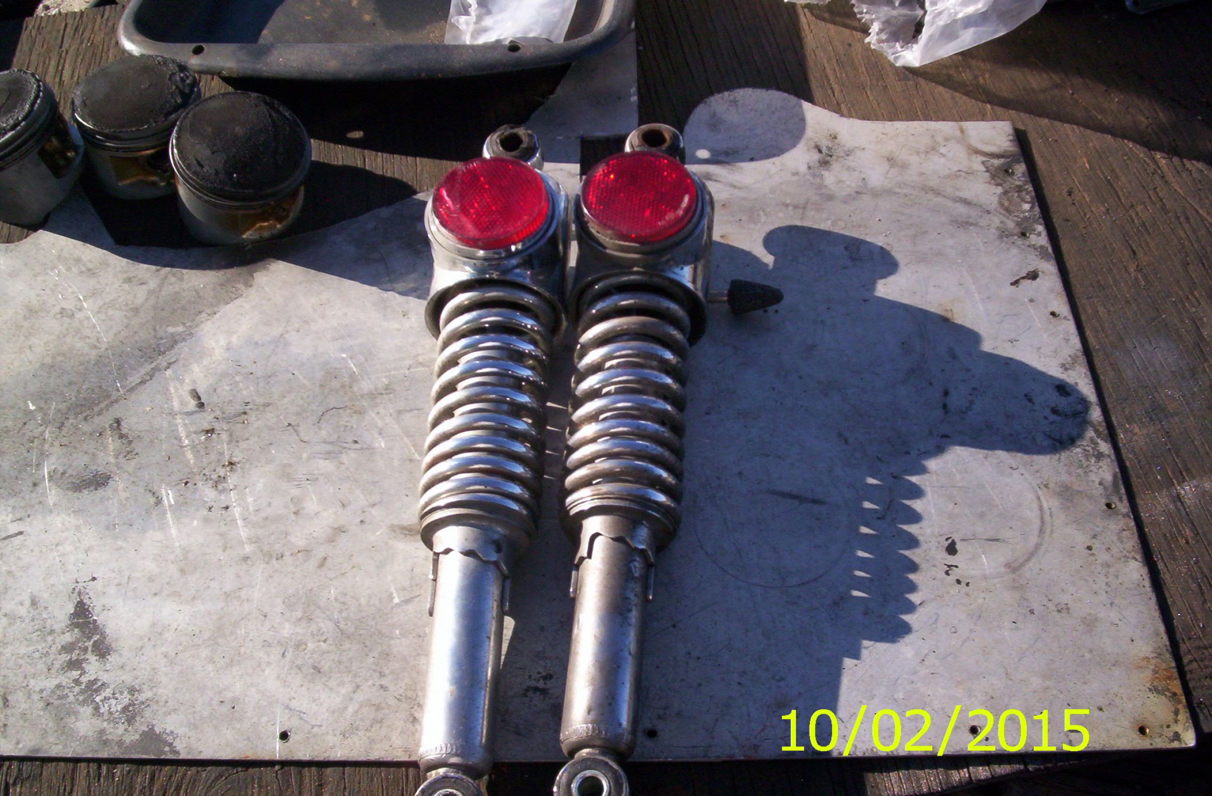

The pin is buried in the casting. I guess it would be possible to drill enough on both sides to get to it then drive it out.
I thought about switching the reflectors to my new shocks but if it failed, the Z1 shocks would be junk. :whistle: I'll be posting the Z1 shocks on the KZMarket soon. Have to clean the dirt off first. :dry:

You can use heavy duty zip ties (hvac section at Lowes) or make up a spring compressor. Top mount threads off. I used original Z1 covers on repro shocks.

06 Jan 2017 15:34Kidkawie wrote: Yes.
That was a great idea Kid. The Ikon I used on my Z1 look great, very close, but do not have the reflectors. I am going to dig out my stockers and see how well those original covers might work with the Ikon shock. Likewise, I will see if our springs fit the stock shock - that might be faster and even cheaper than a rechrome.

I'd like to know if they will unscrew.

IIRC, both the original Z1 and $100 aftermarket top mount are threaded.
