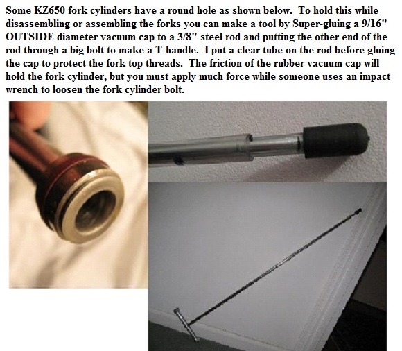

If you find that the hole in the top of the fork cylinder is round (as it is on my KZ650-C1) you have a couple options other than the genuine Kawasaki tool. You can make one as I did (see image below) or you can buy a tool like the one shown here (

Some forks are more difficult than others. I don't know if the guy at the factory used permanent Loctite or what, but on my KZ650-C1 nothing would break the fork cylinder bolts loose until I made the tool shown. With the springs and caps in place fork cylinders just spun around when i used my impact wrench. Using the tool to prevent the fork cylinder from spinning I was able to remove one of the bolts, but the other absolutely refused to loosen. On that one I ended up using the tool to prevent the fork cylinder from spinning while I drilled the head off the allen bolt. Not fun at all. On the bright side, the tool made it easy to torque the new bolts to the torque spec. Ed
