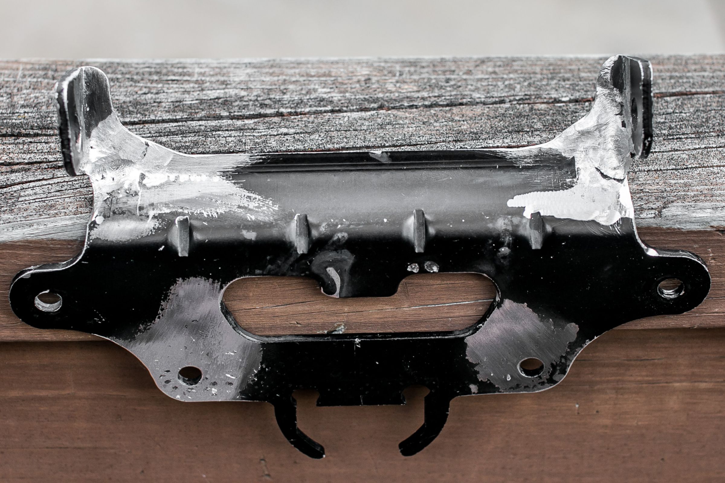

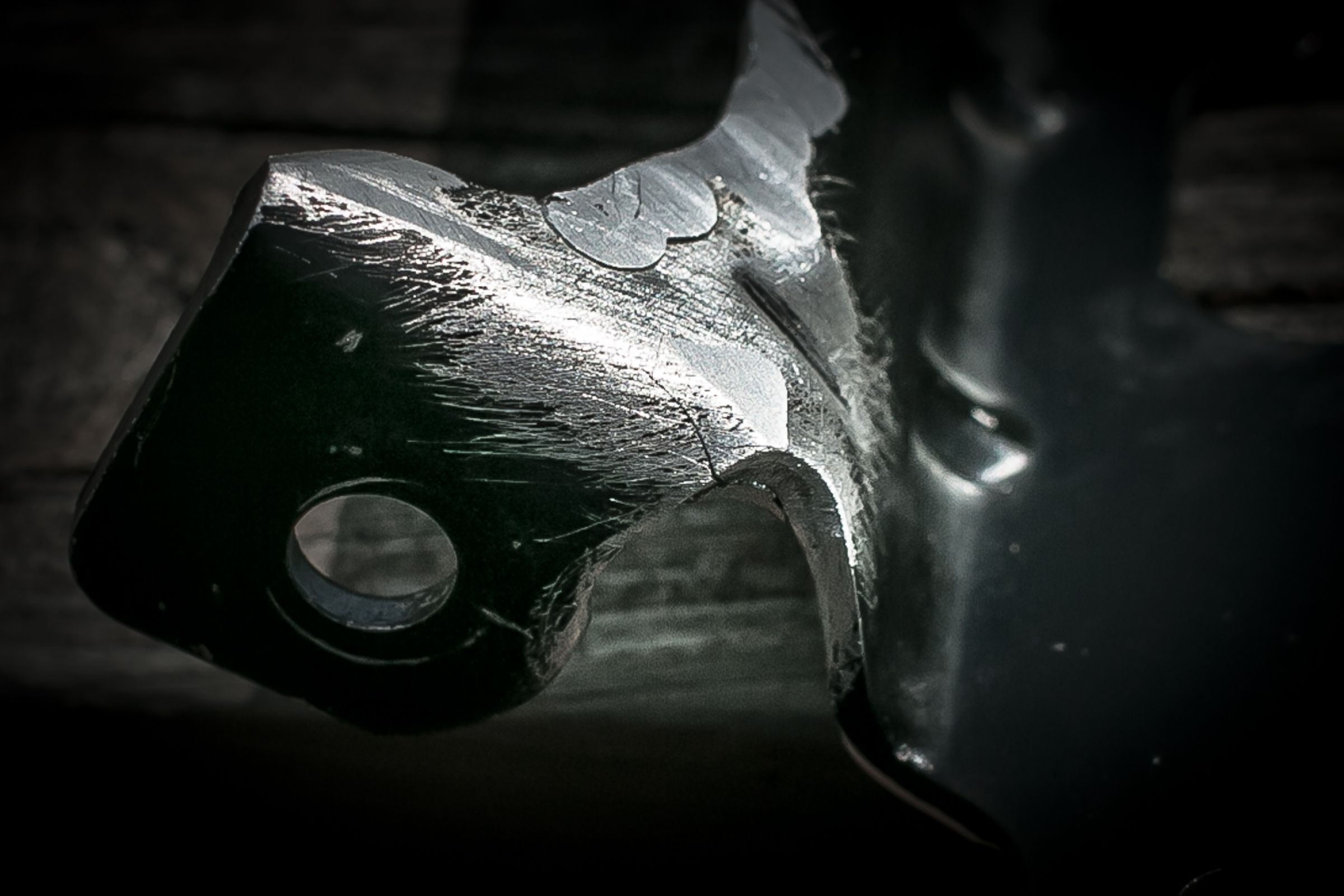

Got it back after welding....this was the partial crack that I could still see on one side. It's welded on the other side.

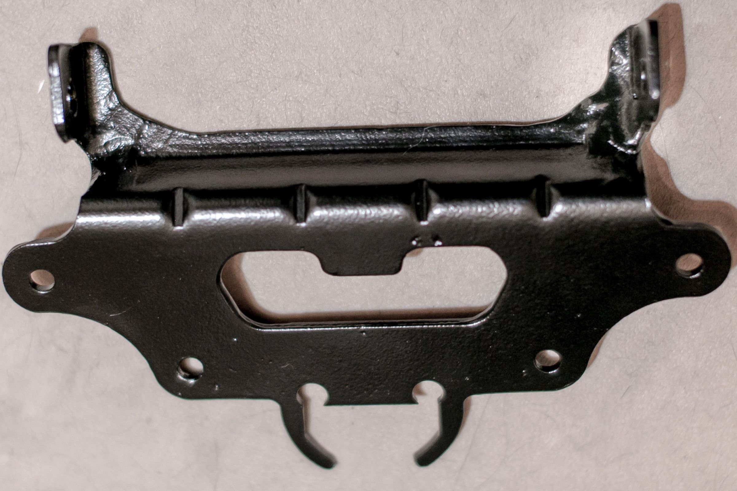

Before and after powdercoating....man I love powdercoating.
And so that's that. Decided against fabbing my own bracket, I have more important problems and projects to deal with right now. I'm just glad to be back on the road.
