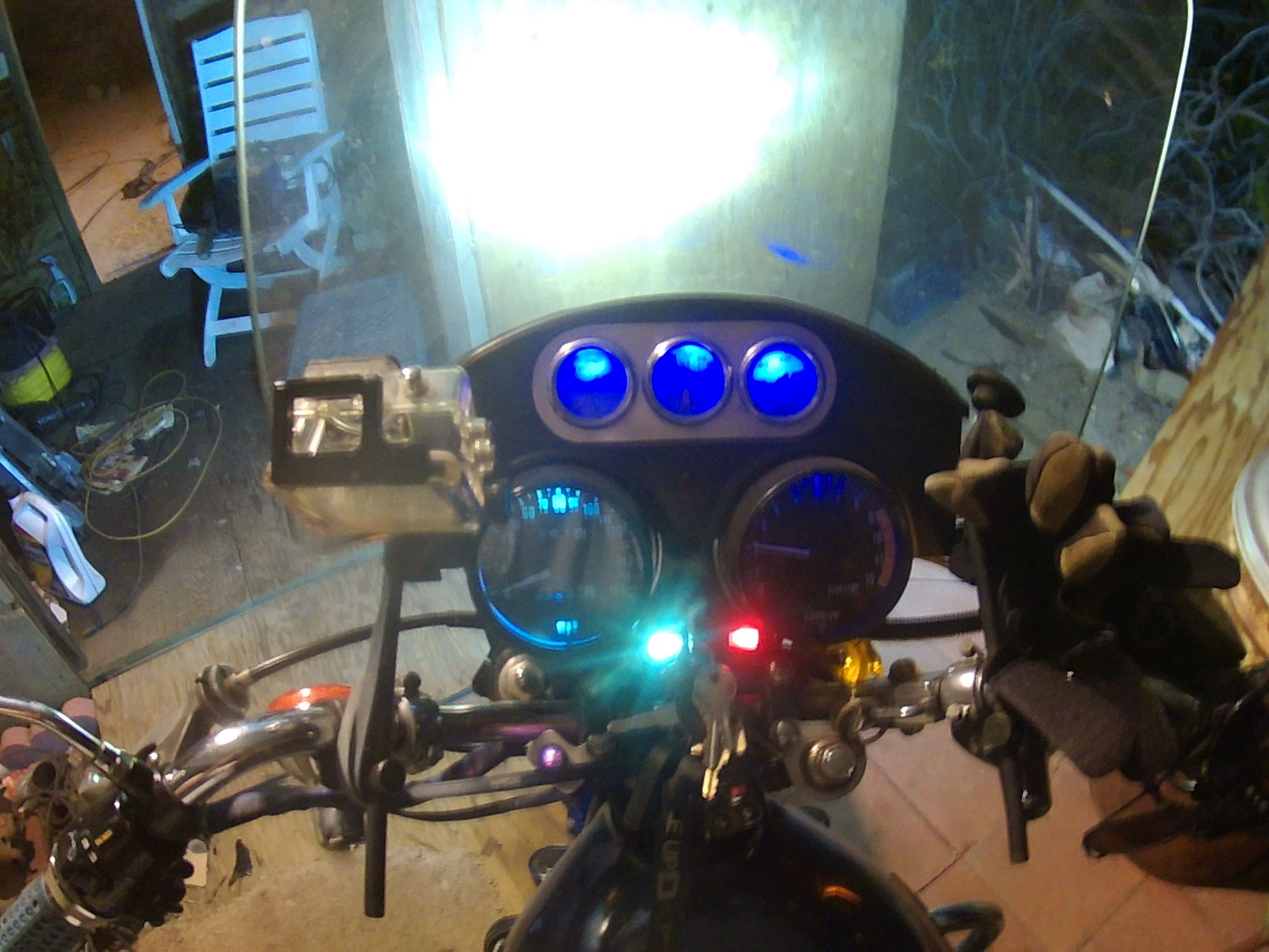

They are in rubber holders in the back. I used LED bulbs.
The speedo has "super brights" and the tach blue regular LEDs.
