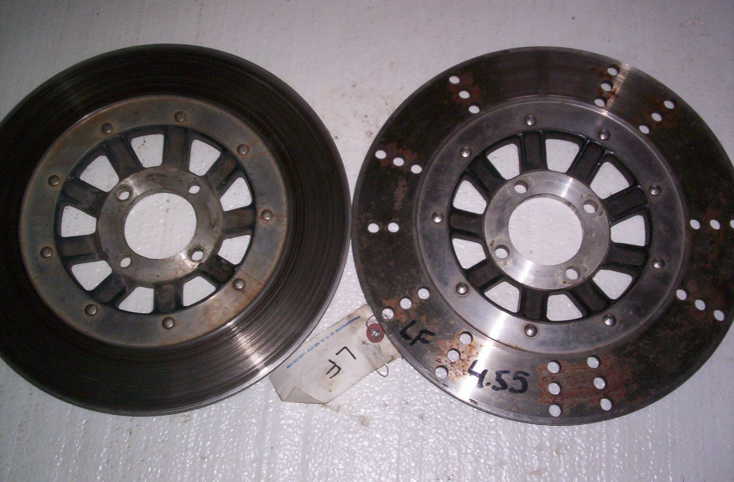

30 Aug 2016 15:03swest wrote: I wonder if a 400/440 caliper will work?
That would be great if someone could provide a measurement. I'd also be interested in seeing if the kz305 rotor fit.
1978 kz200
- Posts: 23673
- Thanks: 2995
Re: Brake swap in desperate need of help!
30 Aug 2016 15:53
I put on thinner rotors. They're almost 1/2 the weight with the holes drilled in them. The calipers had to expand a little more but work great.

Awesome! I'm glad to see it worked out for you. Looks like that's what i'll be doing with my 200. Maybe I'll take a chance on a kz305 rotor because it's drilled too.

The piston in the caliper has probably like 1/2" potential travel. So adding a wee bit more brake fluid it should easily accomodate slightly thinner rotors. Thicker rotors though, no such luck. The only thing I'd worry about is heat dissipation, i.e. the thinner rotors might heat up too much and potentially warp/fade. On a 200 tootling around town probably not a big deal. If you weigh 300 pounds and want to burn up a track thats another matter. Lots of smarter members than me might chime in, listen to them.
