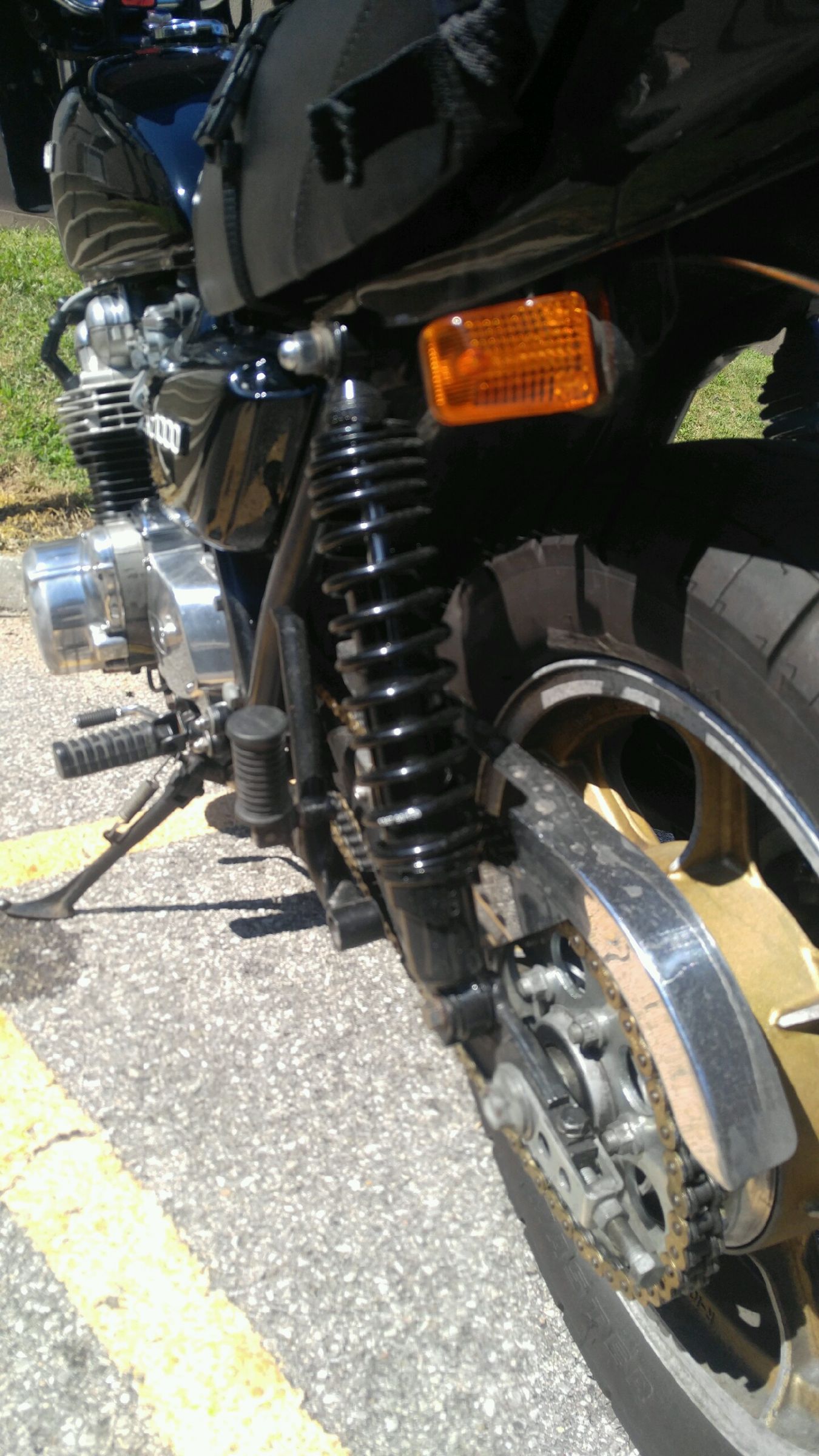

Here's how the 14.25" ones look on my 550 (with Kz550C Ltd springs). You can see the bottom is similar tot he stock shocks, so they should have normal clearance for stock exhaust.
I'm curious to see if the 13.5" shocks are different.

Shocks went on without any issue, fork springs in as well.
I really like the fork springs, I also like the shocks but wish I would have went with 13".
Much better ride and feels planted around corners.

glad it worked out, how's the exhaust side?
i think my exhaust must sit just a little tighter to the frame than average, not sure why it's such a tight fit.

Re: Progressive 412 shocks, anybody happy?
11 Aug 2016 08:32
My exhaust stops short of the rear shocks, so not much going on there
