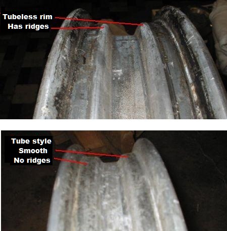

Sorry man but this information is not entirely correct.
The front wheel on my KZ750 was imprinted "tubeless", however there are NO tubeless ridges. I have a Suzuki GS wheel that's same.
These extra ridges are a safety feature, they are not a required feature for use with tubeless tires.
There is no risk of blowouts running tubeless on wheels w/o the ridges unless someone lets the air pressure fall to a very low value, in which case you are at serious risk even if tubes are present.

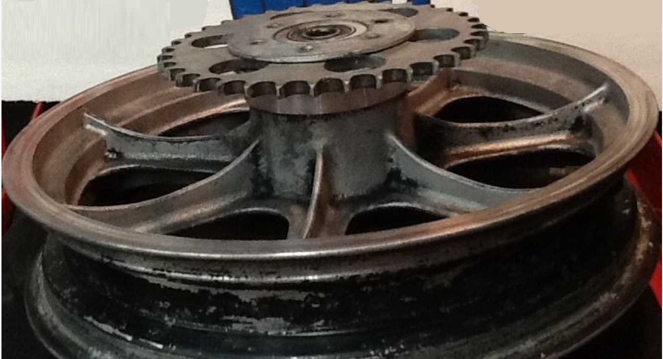

I believe the following photo shows a raised ridge in the rear wheel rim of the Morris Mag (which came stock on the 1976 KZ900-B1 LTD model), and which may be the "special design" referred to in the FSM excerpt:
Yippee! :woohoo: -- raised ridges AND tubes.

That Morris wheel is the first I've seen that was tube type and had the ridges. I've never seen a Japanese wheel that way.
So again, some of the earliest tubeless KZ and GS wheels didn't have the extra ridges. I'm 99% sure those wheels are identical to the tube type wheels EXCEPT for the machining of the valve stem hole. Modifying a tube type aluminum wheel to accept the tubeless valve stem effectively duplicates what the factories did and allow use of tubeless tires.
A tubeless tire isn't going to catastrophically deflate when hitting a bump because the extra humps are not present. If that was a risk then how come Kawasaki and Suzuki sold bikes with such wheels?

Thats not so much a raised rib as the center part of the rim is deeper.In the research I've done regarding this matter I found that tubeless rims have a deeper rut running the inner circumference,like the one in the picture.In my case you can see the tubed rim has a shallower,the rear tire is deeper.I believe that Morris mag you show is a tubeless rim

22 Jul 2016 15:30Nessism wrote: ..........So again, some of the earliest tubeless KZ and GS wheels didn't have the extra ridges.......
As you say, this is true of the earliest tubeless wheels. However, later wheels have the ridges. There must have been a reason for those ridges to be added to the wheels. Is it possible the reason was related to problems of tires deflating quickly? I doubt we we ever know for sure since it is unlikely Kawasaki would publish anything documenting such a problem if it existed, but since those ridges are not cosmetic, it's unlikely that Kawasaki made that change without a reason. Ed

22 Jul 2016 16:52650ed wrote:Nessism wrote: ..........So again, some of the earliest tubeless KZ and GS wheels didn't have the extra ridges.......
The ridges are a safety improvement. No doubt. But this improvement would affect tube type wheels just as much as tubeless.
