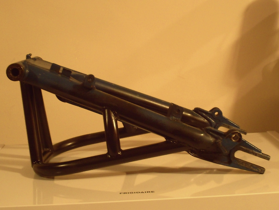

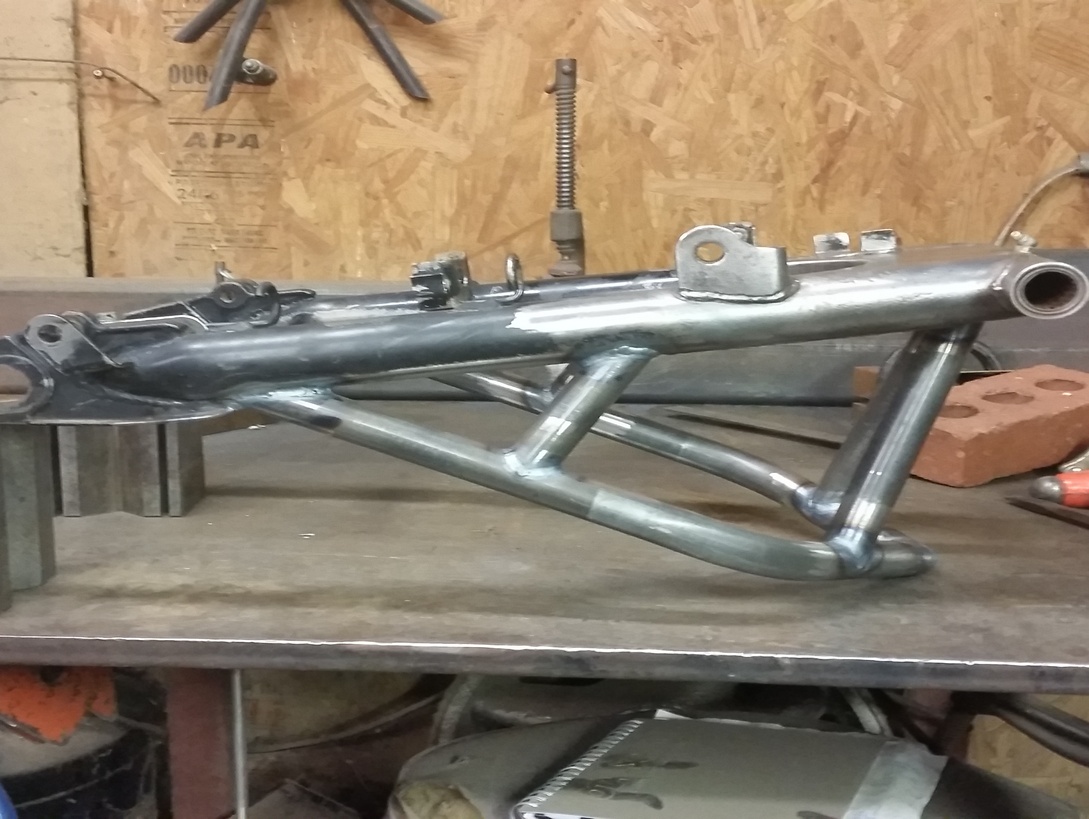

- Posts: 7442
Re: 1981 KZ1000 LTD Swingarm Swap
13 May 2016 07:22 - 13 May 2016 07:30
Last edit: 13 May 2016 07:30 by 531blackbanshee.
- Posts: 7442
13 May 2016 07:36
- Posts: 7442
13 May 2016 07:38
rstnick and dcotorot both have stock underbraced arms as well.
it's pretty open to interpretation.
shows us what you decide.

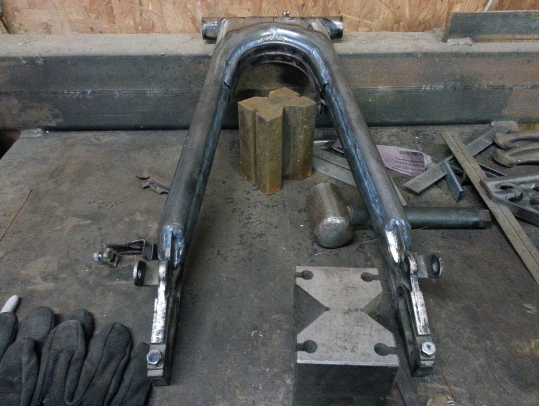

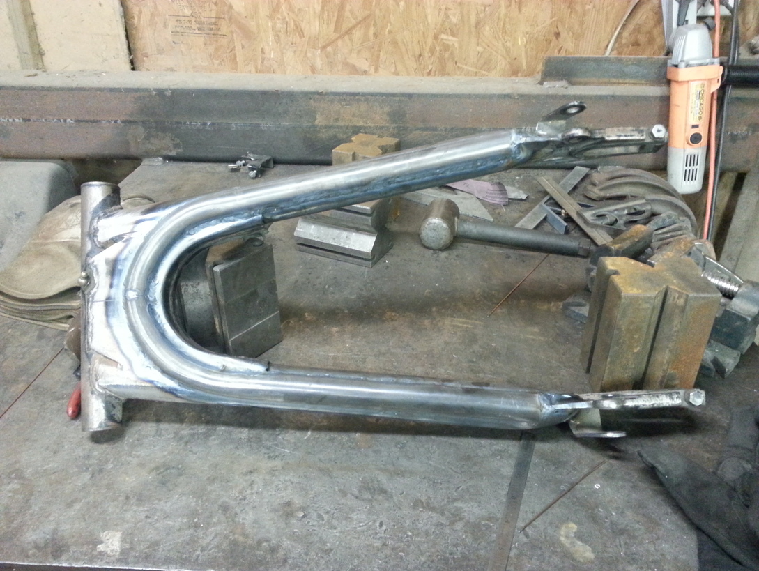

- iwish4a69camaro
- Posts: 20
13 May 2016 08:03
Wow thanks,
Those pics were ultra helpful. I really appreciate it. I'll be posting the process here in my build thread.
I'm a little worried about it warping as I TIG it. I guess I'll V-Block the hell out of it and weld small patches at a time.
