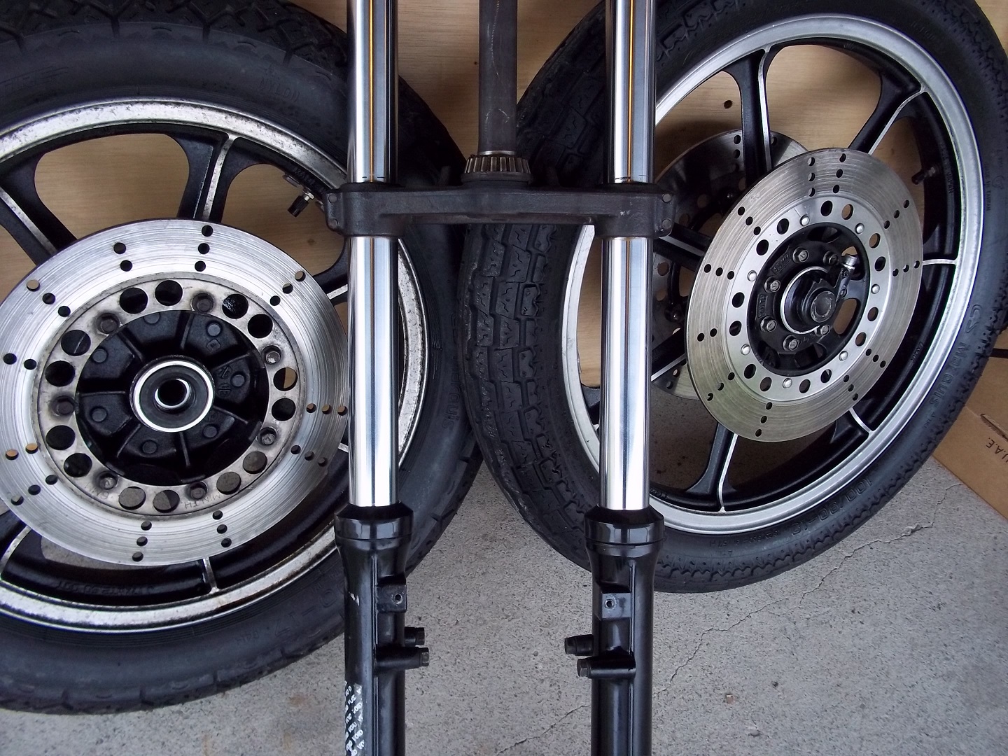

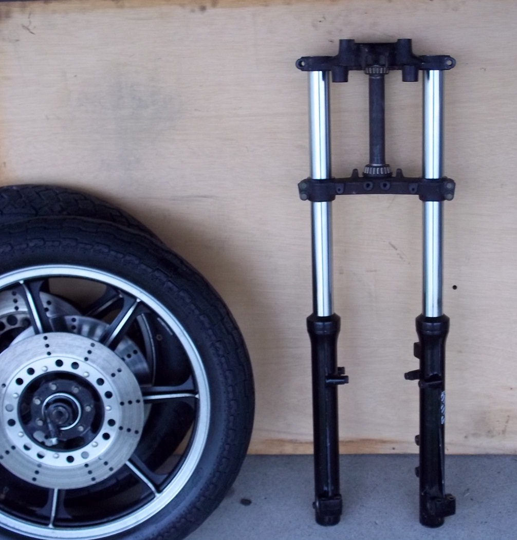

I am new to the 1979-80 KZ 1000 shaft drive model . I have learned that parts are a whole lot different than chain drive models.
But the front ends were beefed up to 40mm tubes. The front wheel axle was placed in front of lower leg.
The trip tree's were wider. I was wondering if these parts morphed into the KZP police bikes?
