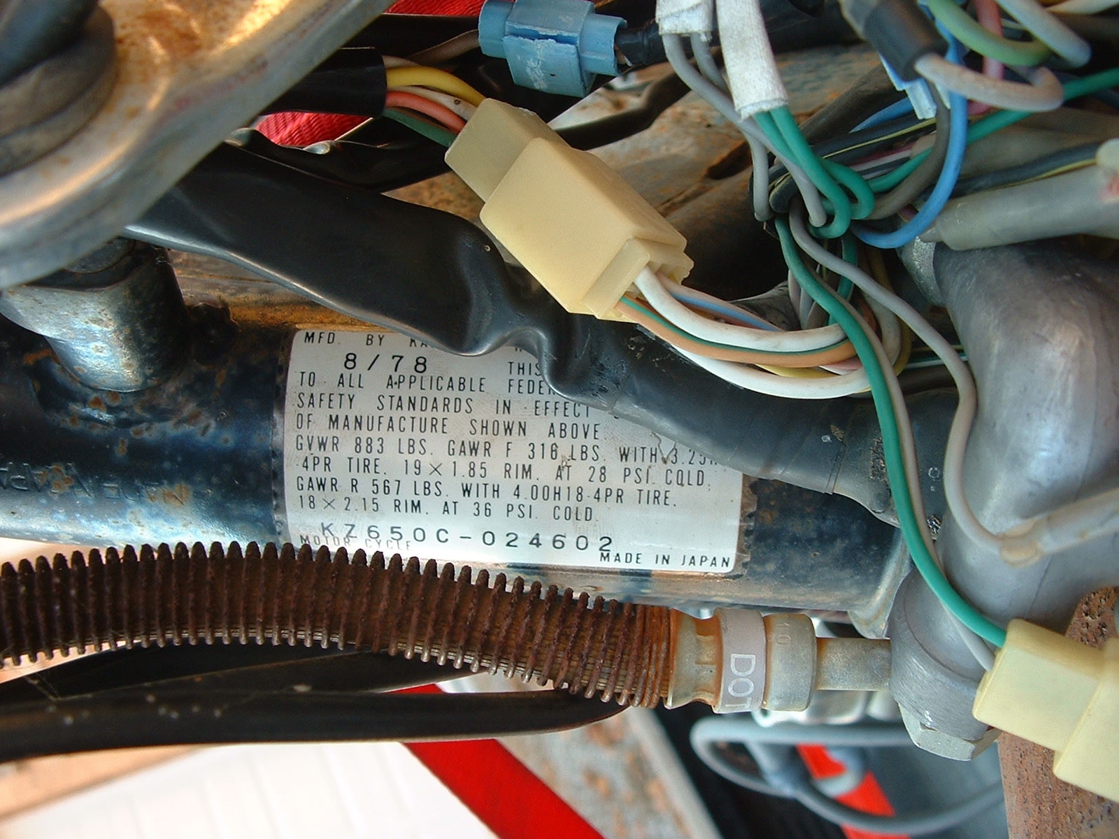

I have a question regarding the date of my 650.
Does the date printed (sticker on frame) equal the model year or did Kawasaki produce vehicles in years prior to the actual release production model year?
I was looking at some pictures on my computer of the old '650 and found this one:
So is this bike a 1978, made in August of that year?
OR
Is it another model year, perhaps a 1979 or even later?

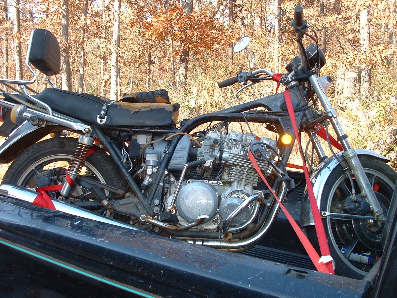

What's up with that? I seriously don't think this bike was repainted although I have little to go on but the duck bill visible under the rear luggage rack here:
OR

It was manufactured in 8/78 for the next model year, so what you have is a 1979 KZ 650 C3 model

Correct; it is a 1979 KZ650-C3. For verification take a look at the frame numbers in the link below. Ed

The sticker says - KZ650C-024602
