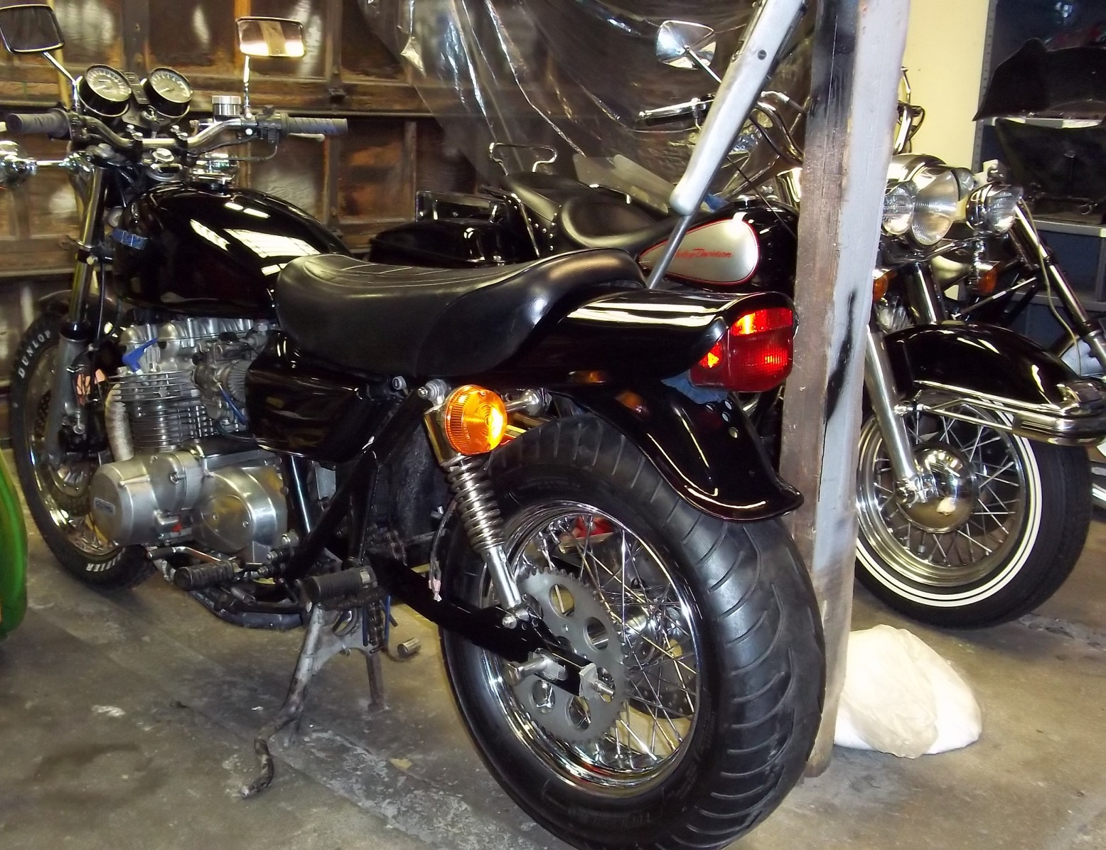

NO 17" Old School will not let you in to the class room!
Stick with 18" you can go to a 180 tire with the GS swingarm.
But you will need a 5/8" offset or you can cheat with a 3/8" offset countershaft.
The 2 spacers you need are .160" thick if you machine them.
I always sell my stuff then regret it. I had this GS swing up before Christmas. Hope someone on the forum bought it.
And a few years ago I had this Harley that would have fit the GS. The tire was a 180.

z1kzonly I saw your gs swingarm back before christmas it was really nice! I wish I had the money at the time I would have been all over it. The one I got was cheap but it's gonna need a lot of work. That harley rim and tire looks massive! I can't believe that thing would fit. that's crazy.
