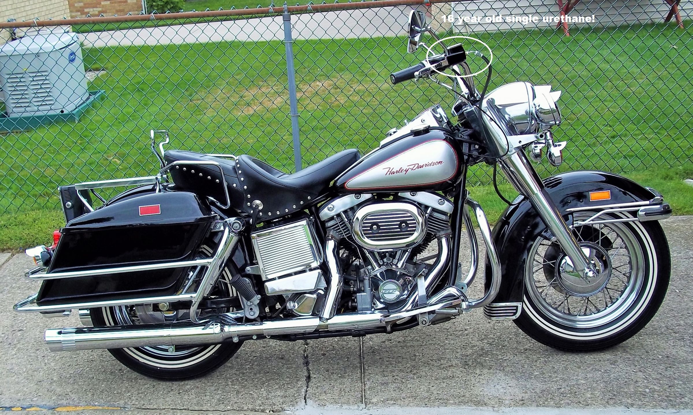

I have been using DOT 5 for well over 30 years! For the paint reason.
Yes you have to clean the whole system out first. I never got brakes hot enough to create moisture. Silicone fluid does not absorb moisture.
I have this in my old FLH. (picture) I can take the cap off today and the 16 year old fluid is still purple! NO moisture in there.
Painted the master cyl. with black single tage urethane in 1999. Paint looks like fresh paint as I did it today.
And I am getting back to the Kaw project, I just cleared my glass beaded aluminum., with clear urethane. And when it's put together, I am using DOT 5 also.
BUT! cheap, JUNK "K&L and EMGO" rubber & seal rebuild products suck! Fluid might swell them?
Stick with OEM Kawasaki rubber parts.
I know what I have, and will use it.

Man, that is one CLEAN Harley!! Very nice! Ed
