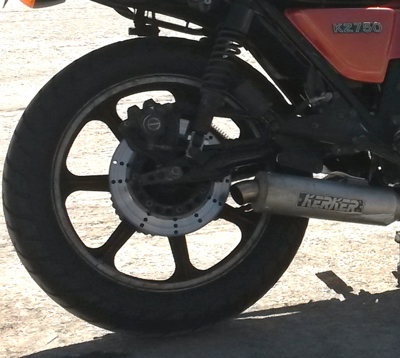

I just checked my bike budget and it's bust. Looks like DIY spacers for now.Shouldn't take more than an hour or so to knock some out. I'll just shamelessly use this pic for a print.

Home brew, 30mm extensions. Good thing I didn't order any from ebay they would have fit pretty sloppy. I actually like them. bike handles well, It got me to the top of the canyon nicely.
I'll keep an eye out for a good deal on a set of actual 365mm shocks preferably piggy-backs. Except standard coil overs would look retro which is a bit of what I'm looking for.... Great another decision to make.
