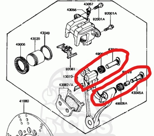

Does it release if you open the bleed nipple
Page 1 of the below link shows master cylinder operation (I know it's for a front but the principle is the same)

19 May 2026 07:23 - 19 May 2026 07:32I assume you are talking about the calliper piston ? don't know about the Hayabusa thing but there are plenty of suppliers for the correct seal kit for Kawasaki - also don't forget the calliper needs to slide freely on the mounting pins or the opposing pad will stay applied. Is one side of the disc colouring up more than the other (inner or outer)no it dosnt release and i measure the piston seal inner diameter comes 44mm and piston 39.5mm ? put in the caliper seat comes to near piston diameter. and some ones at the forum hayabusa caliper kit fit it do you know about it?
With the piston pushed back and the pads removed the body of the calliper should slide freely on these pins

they work well sldes caliper . but the piston side shoe pad burns the other shoepad doesnt

Did you check the free play on the pedal that asphalt suggested - if that's ok it does seem to be a calliper problem
