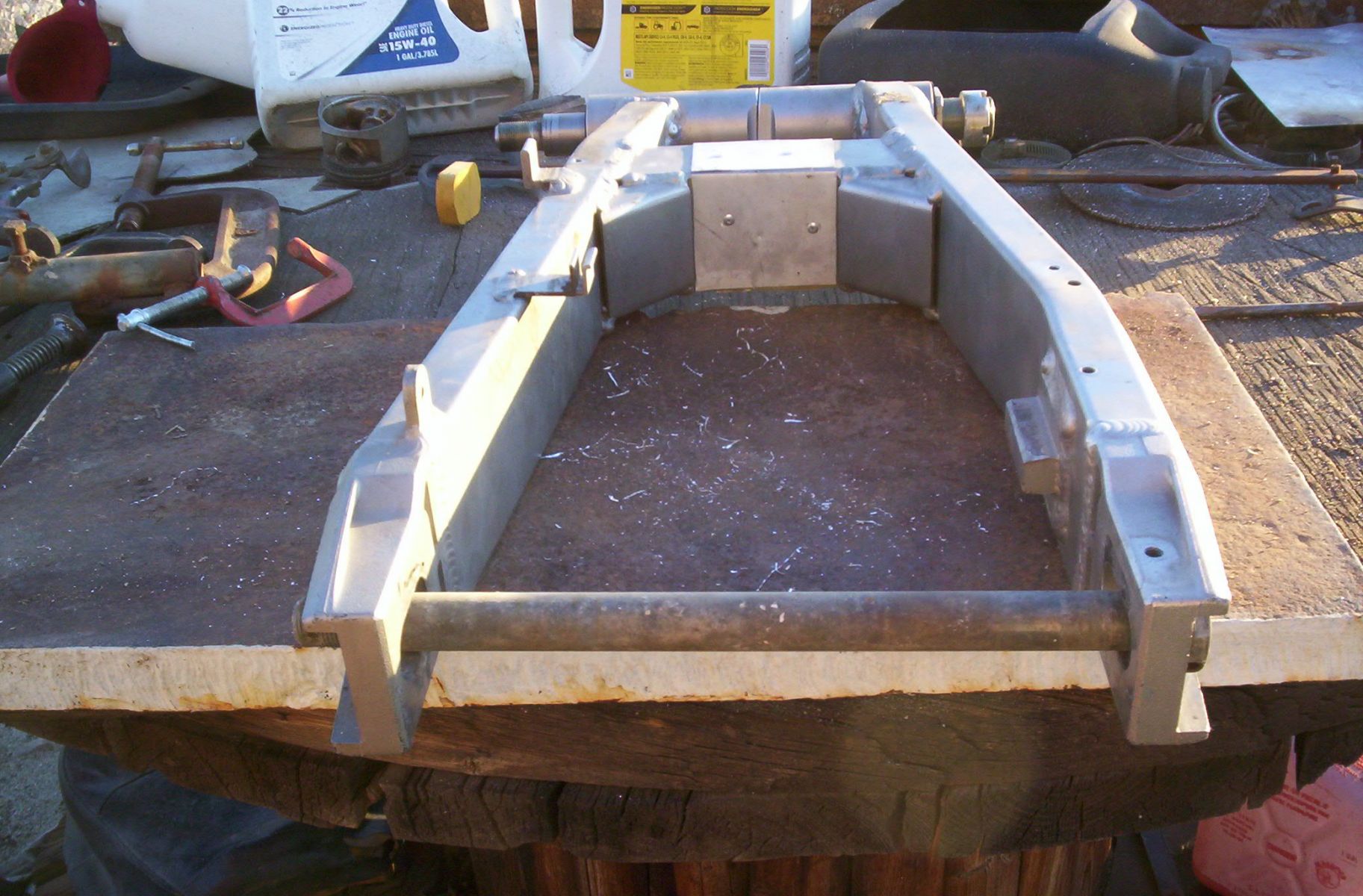

It's about 1" longer. That should help too and not look bad. I love the way it handles stock and 1" longer should make it a little more stable at high speed.

16 Dec 2015 04:13
sweet ,
yeah that will be fine.

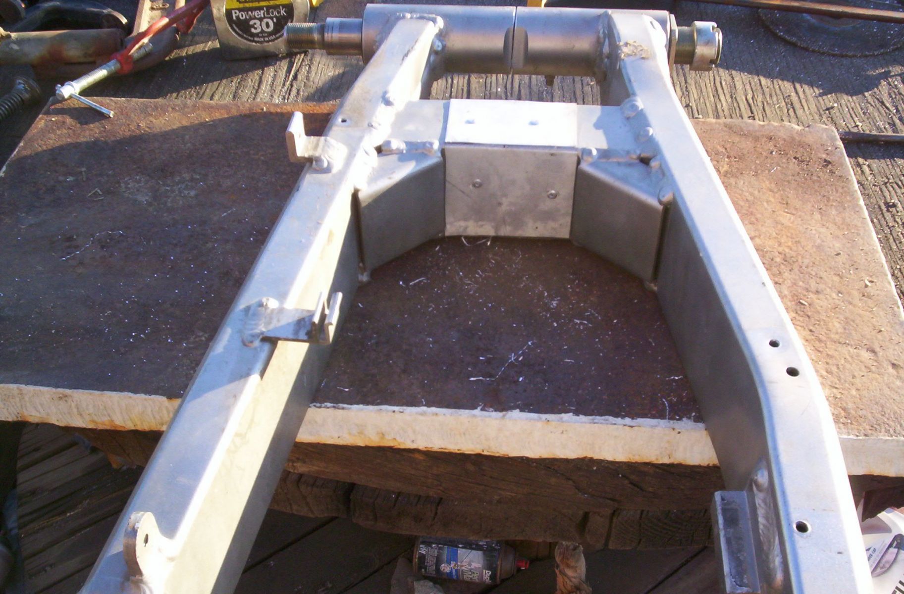

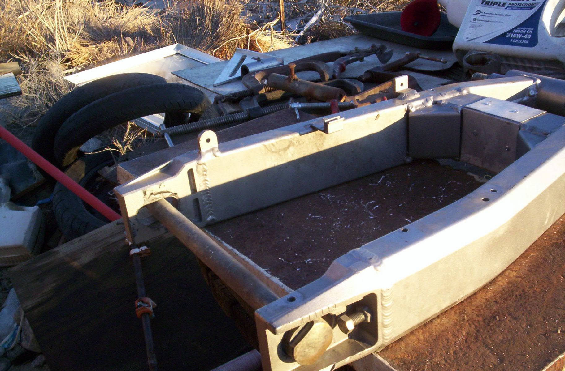

Added a couple temp gussets so I can size it up. Looks like I'll have a lot more cutting to do. :dry:
