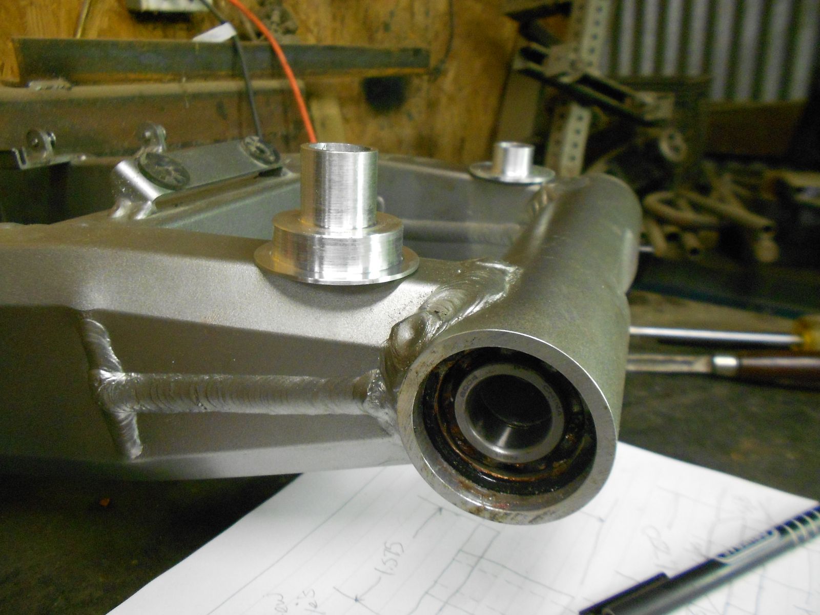

all the zx6/636 arms i have seen have one ball bearing to control side thrust on the chain side,and one needle bearing right next to the ball bearing and one needle bearing on the other side of the arm.
the needles ride on the center bushing with the races installed on it.
kzrider.com/forum/11-projects/539557-76-...200r-build?start=620
the busing in turn buts up against the inner race of the ball thus completing the stack.
i then turn out "tophat"bushings to reduce the hole to the kz bolt size,and act as dust caps.
which may work for you steve.
hth,

That looks almost the same as what I have. Those caps look great. I was thinking of cutting it down the middle to take out the 1" so it will fit my frame and use my stock wheel parts. This thing is a monster. I'll spread it out for pics in a couple hours.
What is the nominal width at the axle?
Thanks Leon
