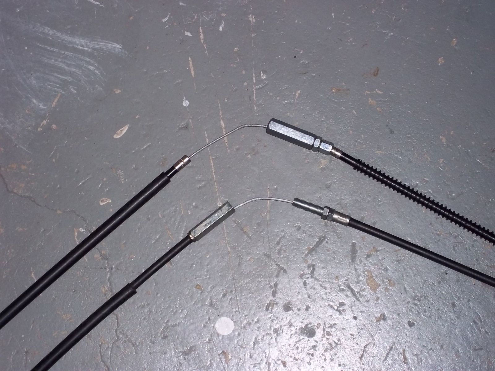

From my experience that "kink" is or wear spot is usually that one where the cable is clamped to the downtube by the header pipe.
The split section with the middle adjuster.
The frayed area is typically where the cable exits the housing sleeve and connects to the clutch lever.
Frequent lube and a nice curve with no hard bends is the secret to very long life!
