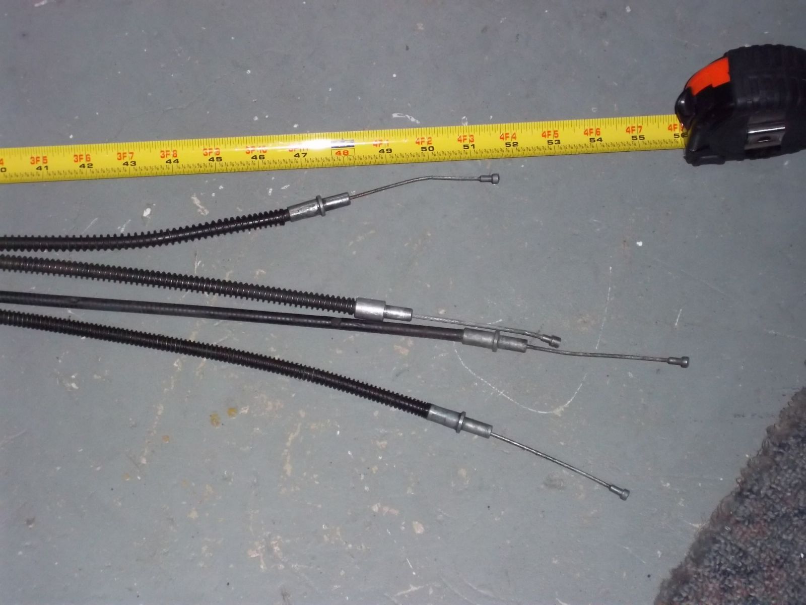

11 Oct 2015 14:04 - 11 Oct 2015 14:04Where were you 6 months ago? These 4 cables sat on eBay for 7 days. I was giving them away for $12.00 to the door. I was paying $5.35 for mailing. No one took advantage? Sorry "oink" just sold a used one for $14.00 plus shipping.
I threw them out, as I don't need anything anymore. I gave up and sold all of my stuff
Last edit: 11 Oct 2015 14:04 by z1kzonly.

Go for the 1978 Z1R cables. They are about 4 inch shorter
