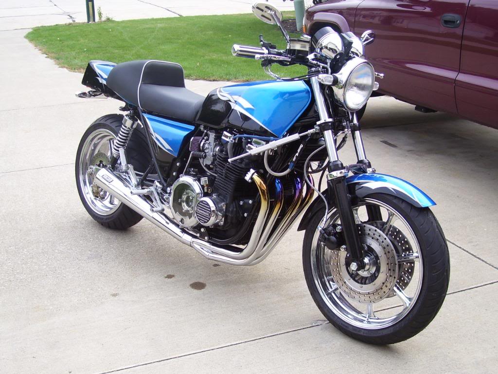

I added a pic with the Z1-R rotors....not the perfect angle but there it is!
79MKII wrote: Sorry I'm so late with this reply...missed this thread completely. Anyway, I installed a Z1-R 18" on my MKII a few years back. Bolted right up, no problems at all. I changed the fender though....your stock fender will look weird with an 18" wheel. I used the Z1-R speedo drive too, not sure how much of a difference it would really make though.
