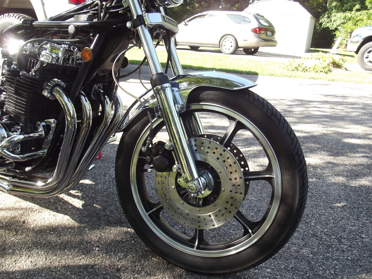

I finally got around to refinishing the 18" Z1R front wheel, and getting it mounted. A few more things to sort, and it will roadworthy

18" Z1R front wheel on my '78 KZ650C2.
Looks smaller than the 18" rear in this picture:
