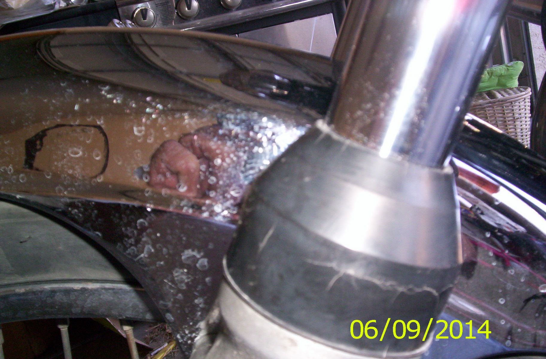

They lost me starting with the over priced defective 40 year NOS fork boots.

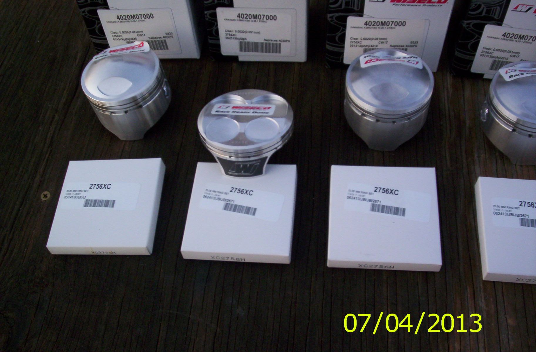

Gave them a pass on the wrong piston and had to wait two weeks for the right one.
Lunched another piston, they wanted to sell me one but it would be on back order. NO DEAL.
