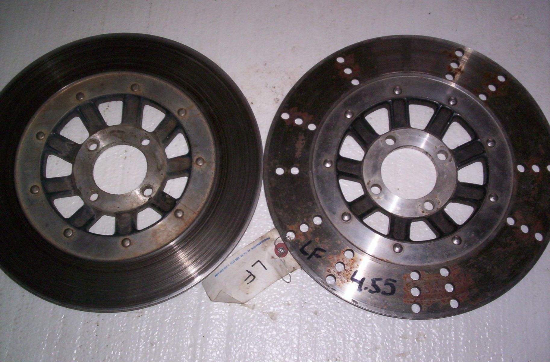

The outside diameter is the important part. Off set too. Mine are 11 5/8" a round approx. The drilled ones are 1/2 the weight so you can go duel. Steve

I'm leaving on a trip so here are the measurements.
OD 11 5/8"
Hub size 57.97 mm-2.28"
Bolt spacing 78.98 mm-3.109"
These are approximate and off a Z1/KZ 900-1000. Will fit other bikes too.
Yours may be smaller.
Just for reference.
OD 11 5/8"
Just for reference.

You can have them drilled for $45 plus shipping.To go duel you may have to buy another fork leg and switch them around. You'll need a different fender and grind off a couple mounts. There's nothing like having good brakes.

Oh and that LF mark on the one disk, There's no left and right, he just wanted me to buy both. Didn't work. :woohoo:
