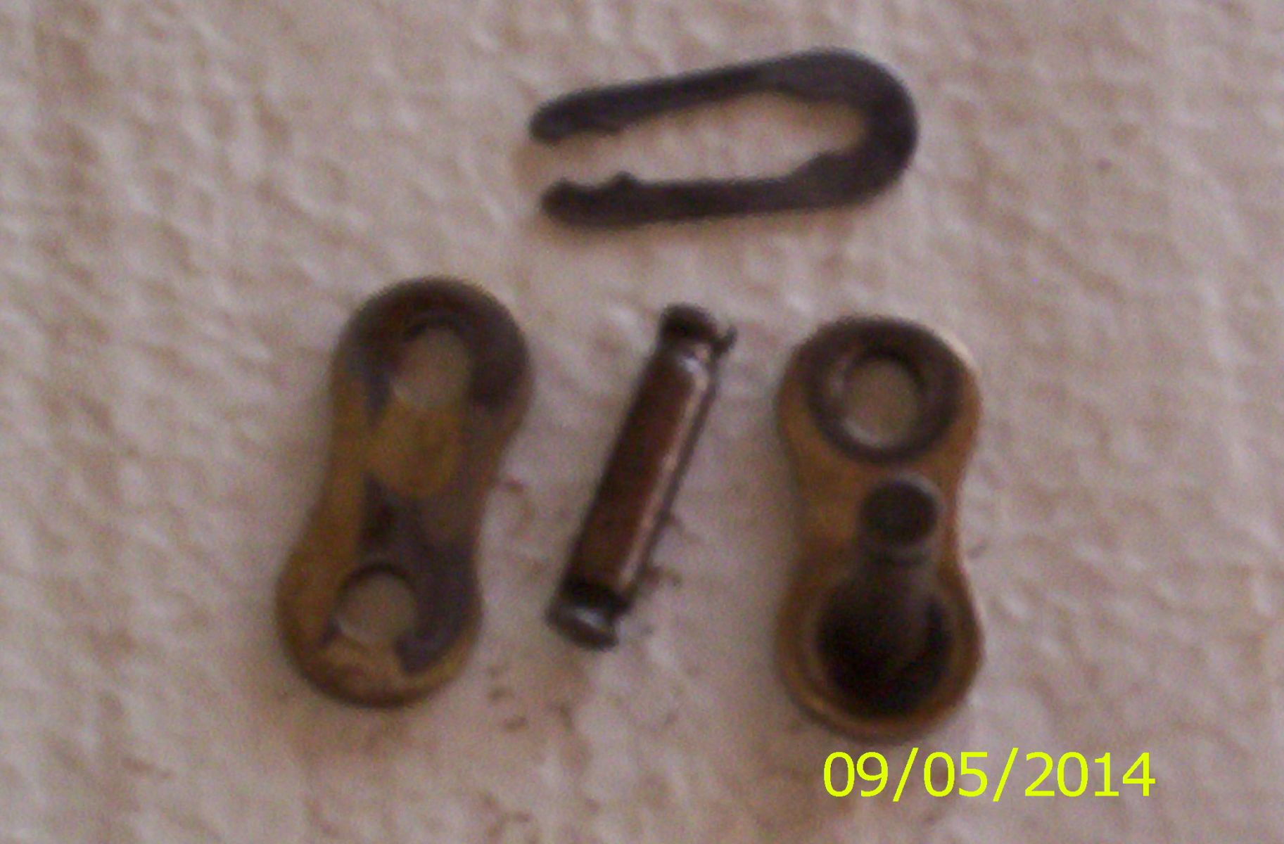

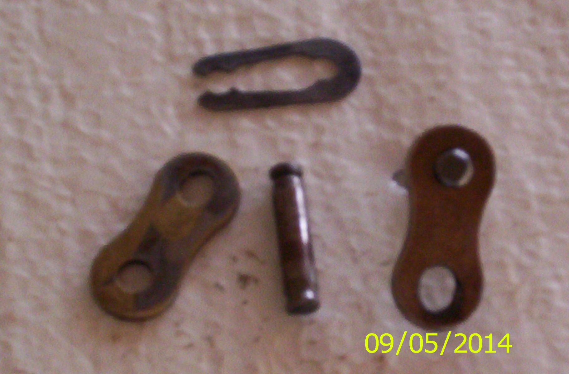

Need help, my chain is off to the left, fine, then off to the right. The hub that holds my gear seems to be out of alignment. Can I fix this while its on the bike? The bike rides fine a i have taking it on a couple small rides and notice this when i was installing the chain guard. In help in getting this straight with out taking the whole back tire off would be great.

Bit difficult telling form the pics but it seems your sprocket or hub carrier is out.
No easy fix, you need to take it apart and check carefully, otherwise you'll be back soon enough replacing them...if you are lucky and it doesn't cause a breakdown or accident. Check your hub carrier carefully, I've seen them crack.
