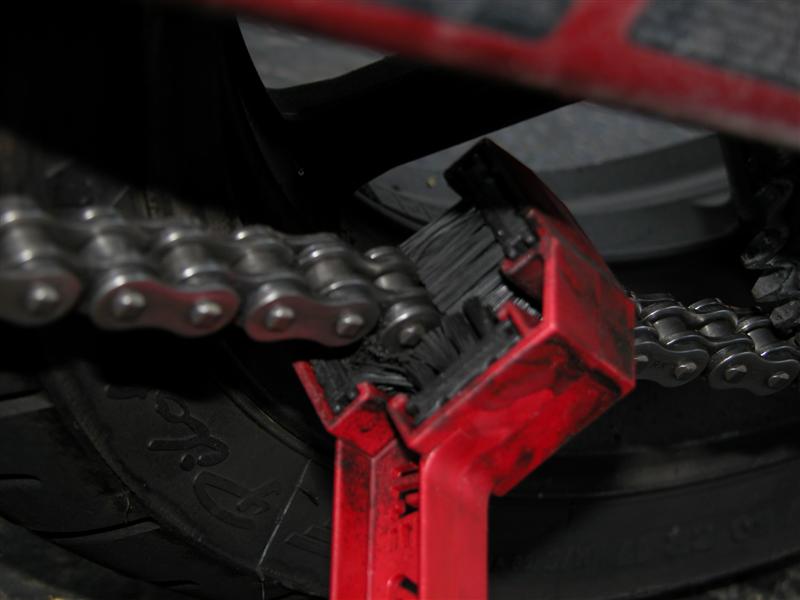

I use PJ1 chain lube. I would advise looking at Manufacturer recommendations. For cleaning and lube. The last one I purchased was X-ring and it had not stretched maybe 1 notch in 5K miles. Cleaned it and lubed it every 300-500 miles. I prefer to ride the bike for about 10-15 minutes to warm up the chain then clean it and lube it.
Oh and if you go O/X-ring make sure you scrub the chain with something like this, You can buy cheap ones at Walmart for under $10.
