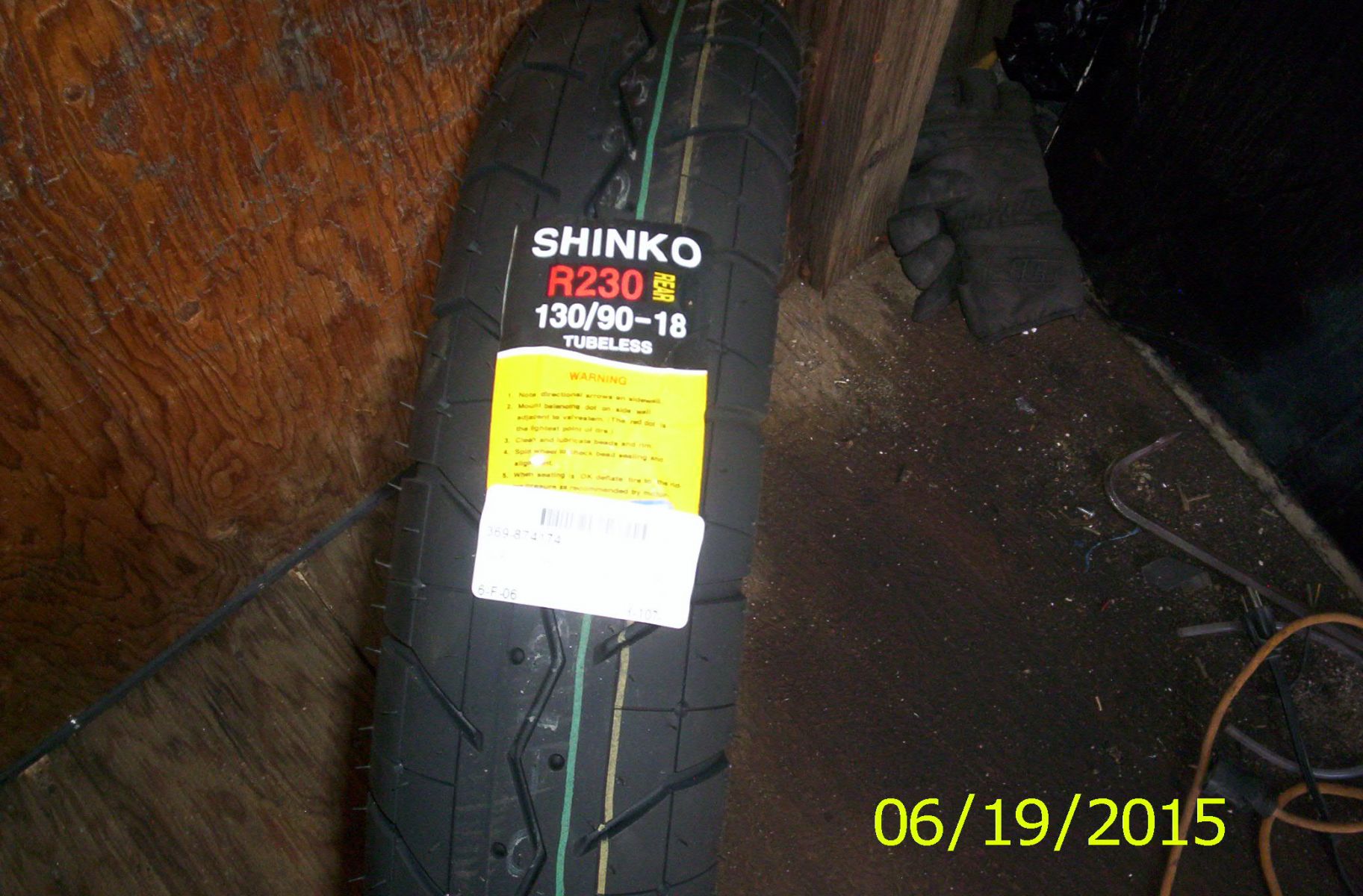

I'm running Shinko Tour Master tires on mine. 110/90-19 front, 130/90-18 on the back. I get them on sale at Chaparral. I had a 100/90-19 up front but it washed out on dirt roads too much. Couldn't wait for it to wear out. This time I have a working odometer so I can tell just how many miles I get on a tire. I figured about 4000 miles but that was only guessing.
