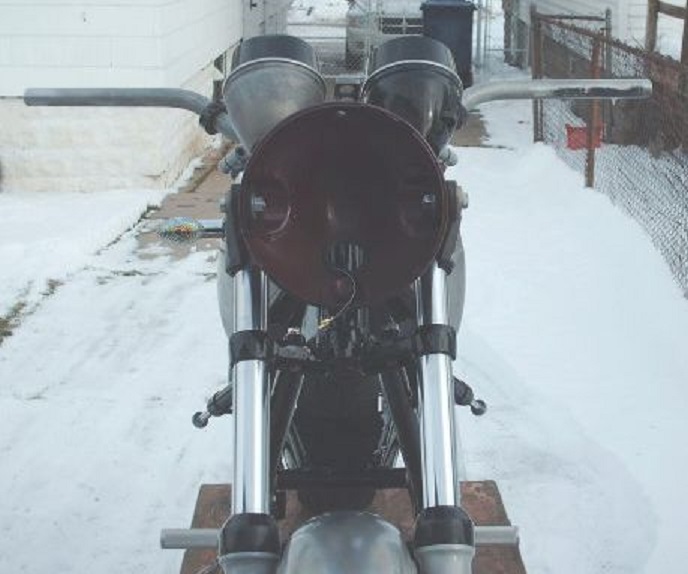

clamp on fork tube, drill out reflector tab?
- Posts: 23785
- Thanks: 3049
Re: steering dampener
04 May 2015 21:29
There is a hole in the bottom triple clamp.
- Posts: 5187
- Thanks: 2339
05 May 2015 07:03If you use the reflector tab to mount the dampener to the frame , you will have to reinforce it with a welded in triangle gusset or it will bend and soon fail.9er rider wrote: clamp on fork tube, drill out reflector tab?
I use the tabs on my bike but added these gussets
