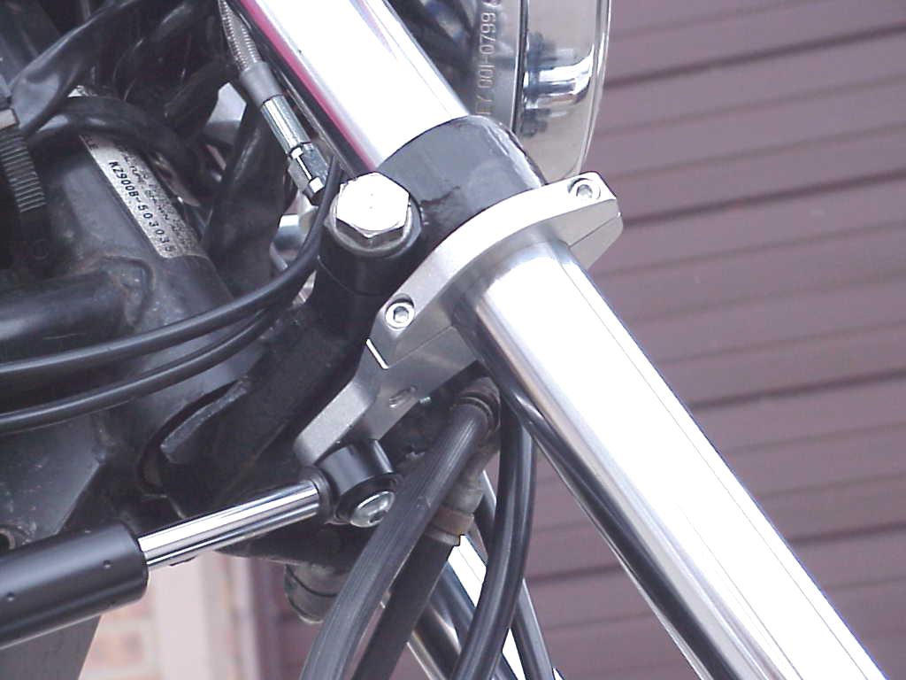

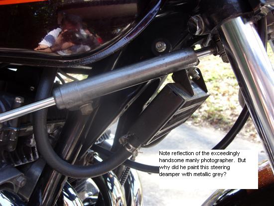

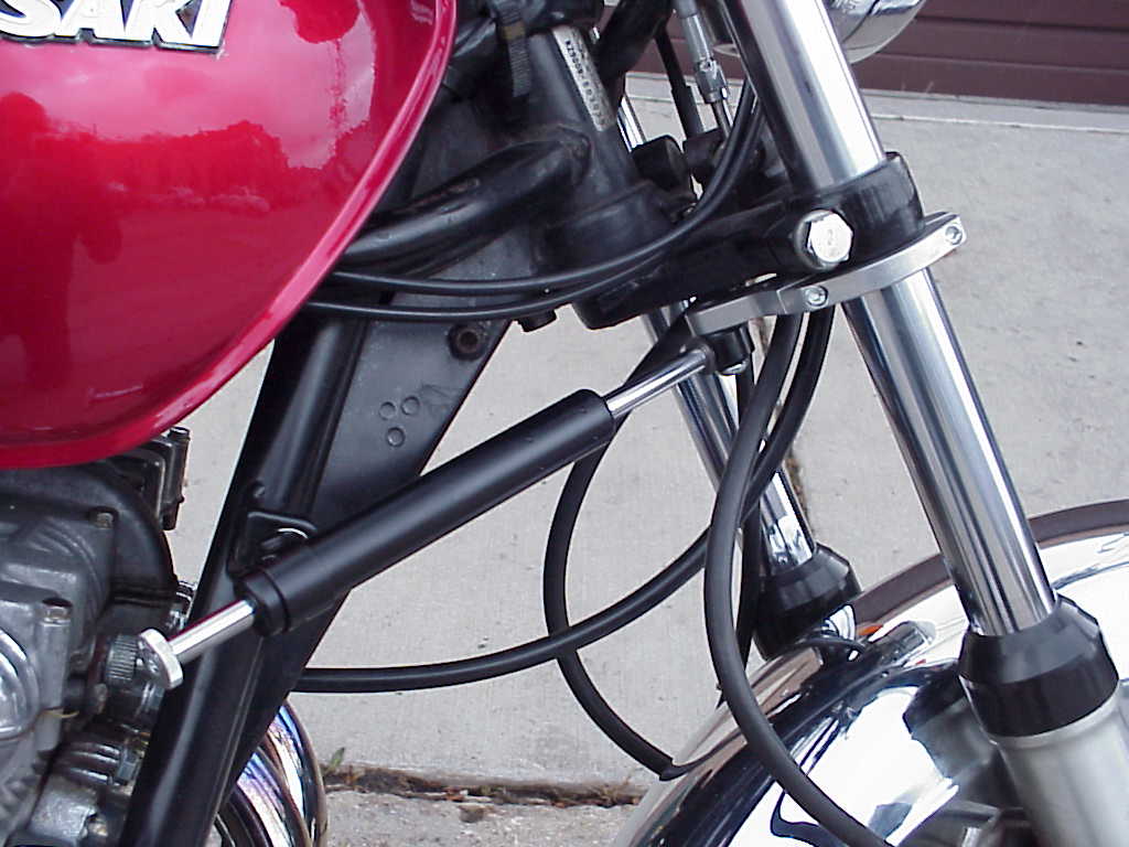

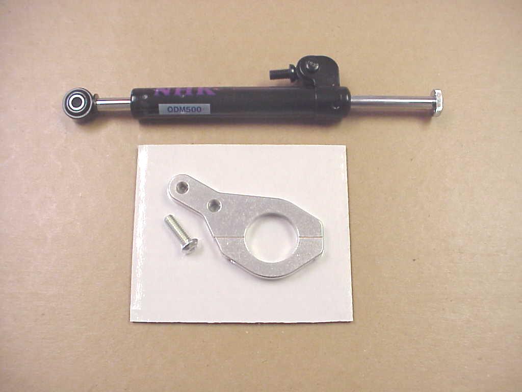

'73 Z1 triple clamp is designed with a hole to fit one end of the steering damper.
I've had no issue with having the other end of the steering damper attached to the stock reflector mount (no added bracing).
The 1976 KZ900 does not have the factory supplied hole.

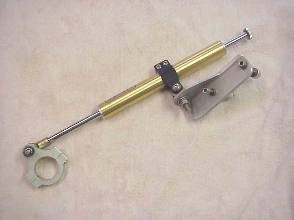

The forward end of the steering damper attaches to a clamp that fits around the fork tube.
There's some good info about this at Redline:
click > www.redlinecycle.com/Steering%20Damper.html
Per Redline:
Rear of damper mounts to the right frame reflector tab on the frame
On some early Z-1 models, there is a hole in the lower triple clamp to which the front of the damper can be mounted, eliminating the need for the front mount bracket...that clamps to the right fork tube of any 1973 to 1980 Kaw 900 or 1000. It will allow adjustable mounting of the front of the damper to any old Kaw...bracket contours the
bends in the lower triple clamp, and mimics the position of the hole in the lower clamp found on the early Z-1's...Rear of the damper mounts to the right reflector tab, which is drilled to 5/16" to accept the damper stud.
Per Redline:

Im glad Patton has shown a lack of failure with a non reinforced reflector tab, But I sleep well knowing mine are rock solid. It was a small detail to add while my frame was stripped down and being braced. My brackets shown in my previous post were purchased from Sandy Kosman.
I now run a set of PDM (Les Holt ) custom triple trees with the Kosman flanges below them.

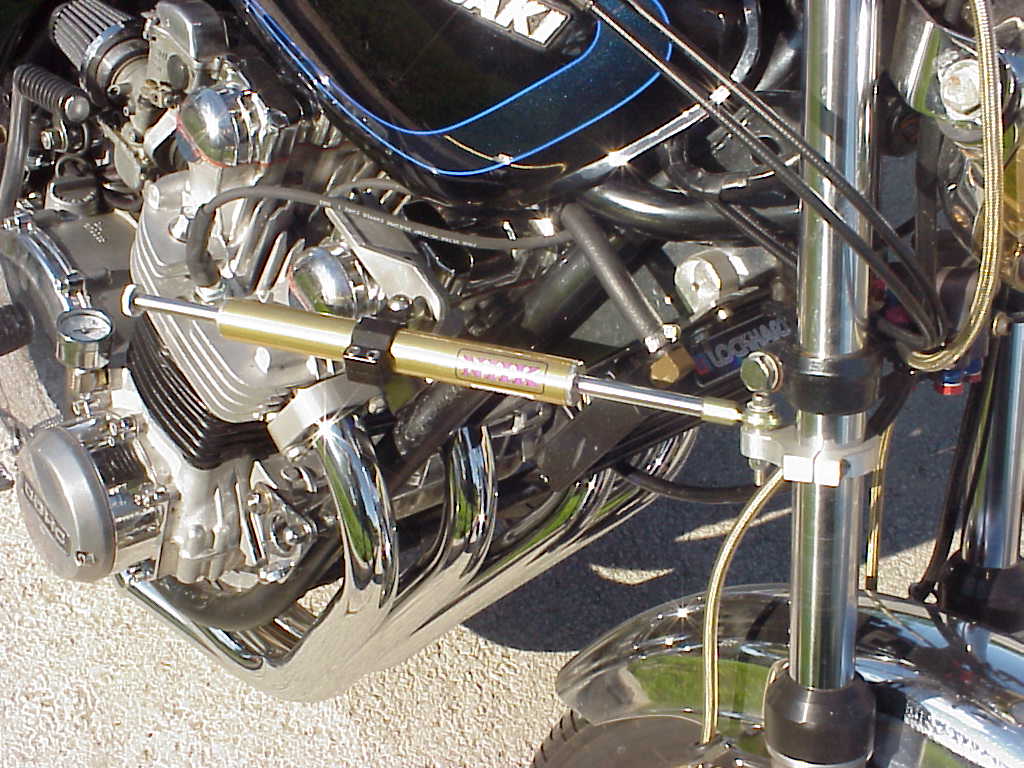

To help reinforce the reflector tab area, I ran a piece of threaded rod to the other side's reflector tab, and connected it with a rod coupler onto the dampener. That way both reflector tabs are connected by the rod and gives more rigidity. You can get metric all-thread and rod couplers online nowadays..
