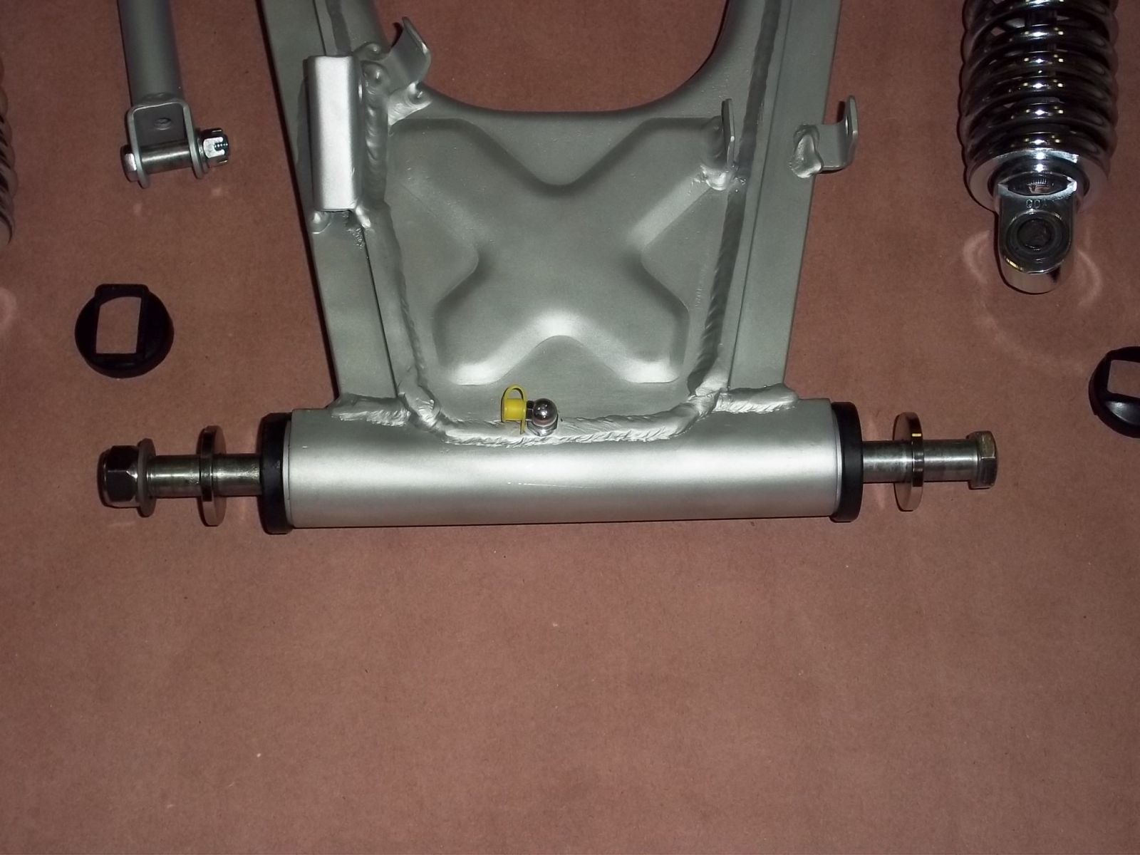

All Cleaned up, new IKO bearings with machined collars. What a difference in bearing prices? These Suzuki bearings are the same as later KZ 1000's TA2530Z. Cut pivot spacers @ .180". .360" instead of .375" Added a zerk fitting.
