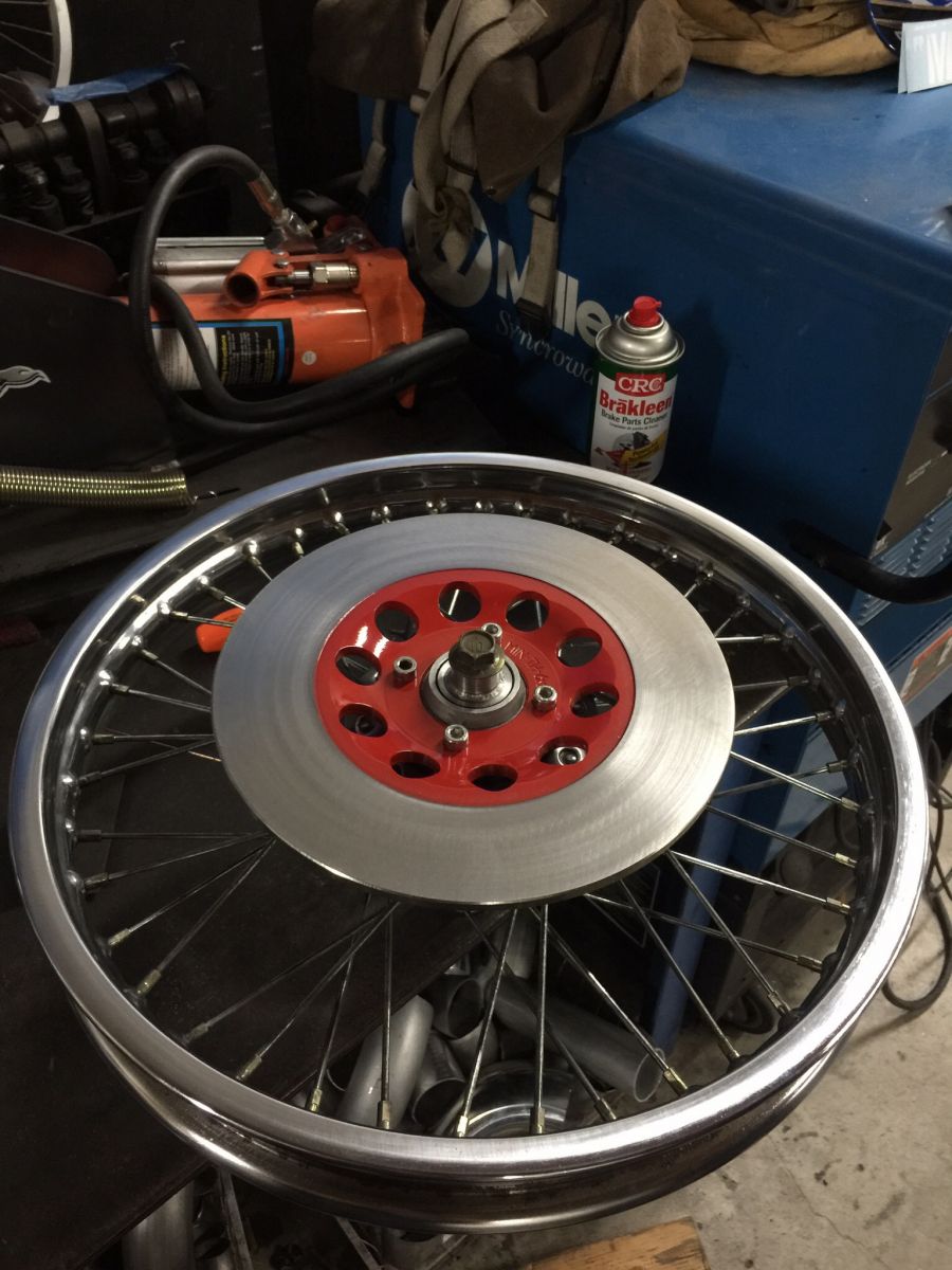

I think a free floating rotor is gonna be out of the question with our 4 bolt setup(I've got a 440 also, wheel) The 440 rotor is drilled and a two piece, but it's a solid two piece. With lots of ingenuity, you might be able to get the rivets drilled then get the floating hardware from brembo, willwood or the likes. Of course I could be totally wrong with all of this and making an ass of myself :dry:
with a bit of elbow grease and patience. before..
After...cheating and using my lathe and air drill..
ed

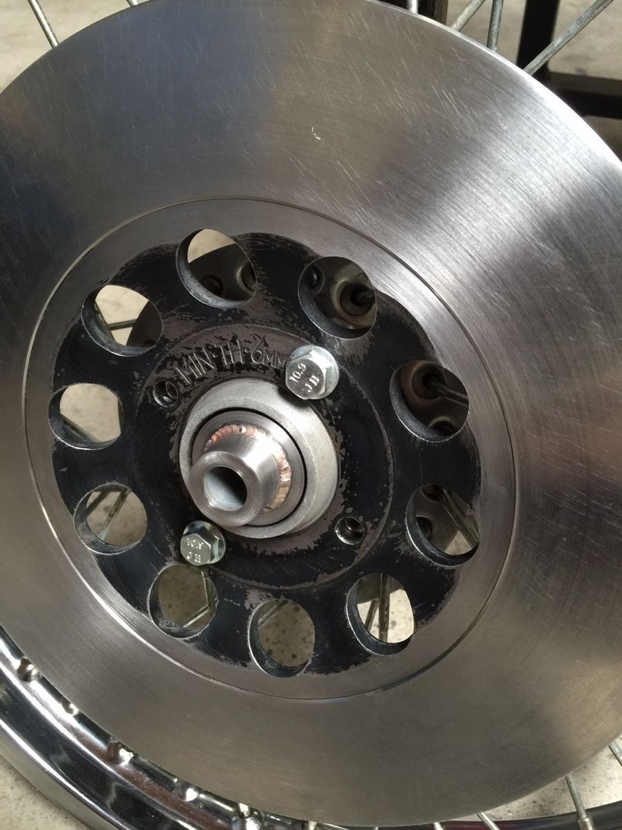

Ed is right, the 4 bolt pattern nearly ensures that nothing will bolt up. If you have access to a lathe you can make an adapter. here is an example a member "fishhead" made

Hopin the 1000 ebc front rotor has the same center bore as the 440 hub. The bolts i can overcome as doc said. The front diameter is a bit bigger too which rules. EXACTLY what i was lookin for... a lighter, bigger diameter (larger than my rear rotor too, just for asthetics personally), floating rotor. Thanks doc!... and ed too. Yer rotor looks bitchin in the pic where its all painted up by the way. Gonna wait to hear back from fishhead before i pull the trigger on the ebc rotors.
