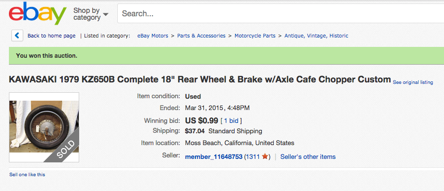

ha! i have been really lucky on ebay lately. Can't wait to try this swap. i already have a set of spokes that I was gonna use on my 650.

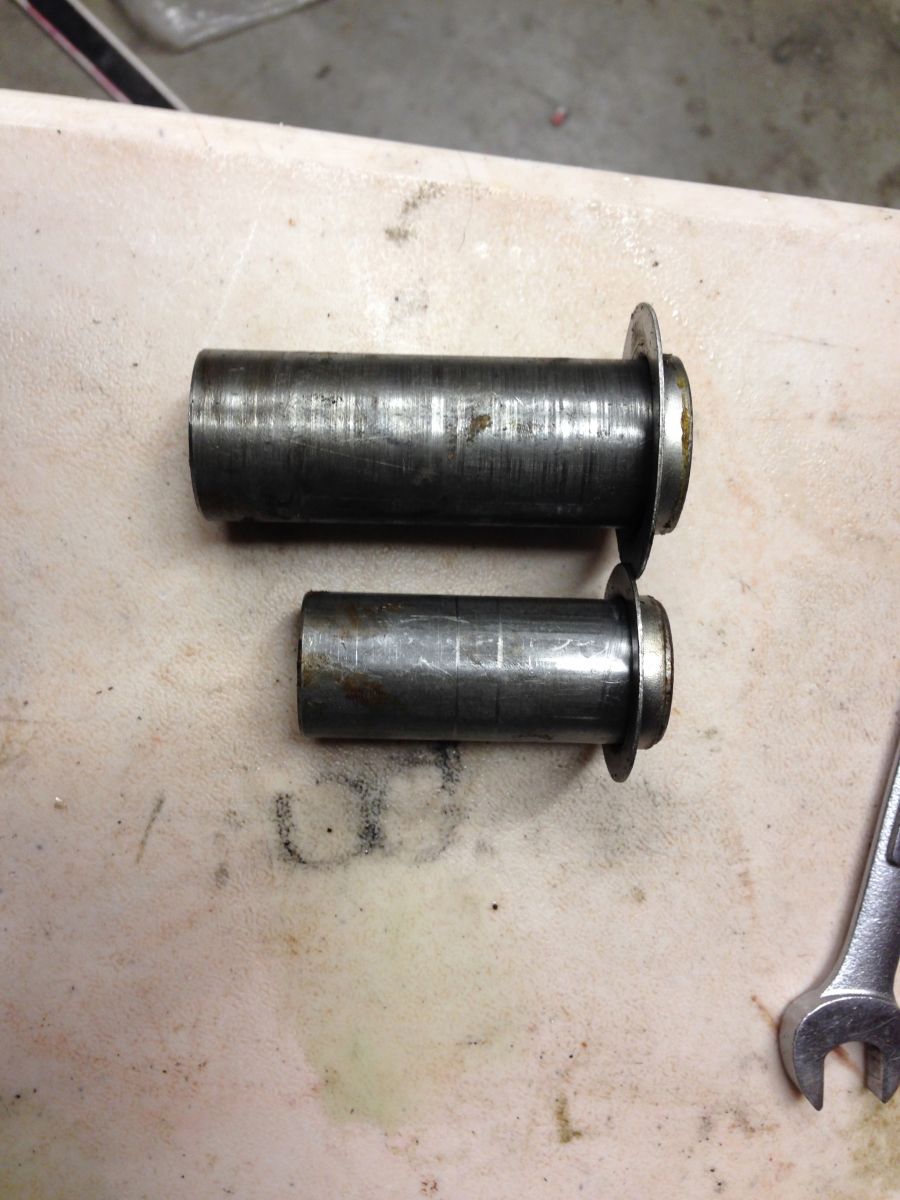

I got the 650 wheel. I had a kz1000 16" wheel sitting around so i pulled the bearing spacer out of that. its longer than the 650 so it can be trimmed down. The 650 brake plate looks like its got plenty to be bored out. My only concern is the sprocket carrier spacer. It is 25mm outside, which leaves a 4mm wall stock. if i bore it to 20mm then it will only have a 2.5mm wall. Will this be enough? Since its only job is to be held in compression between the bearings I don't see it being a problem. The alternative would be fitting a larger bearing in the carrier and making a new spacer, which i would rather not do.

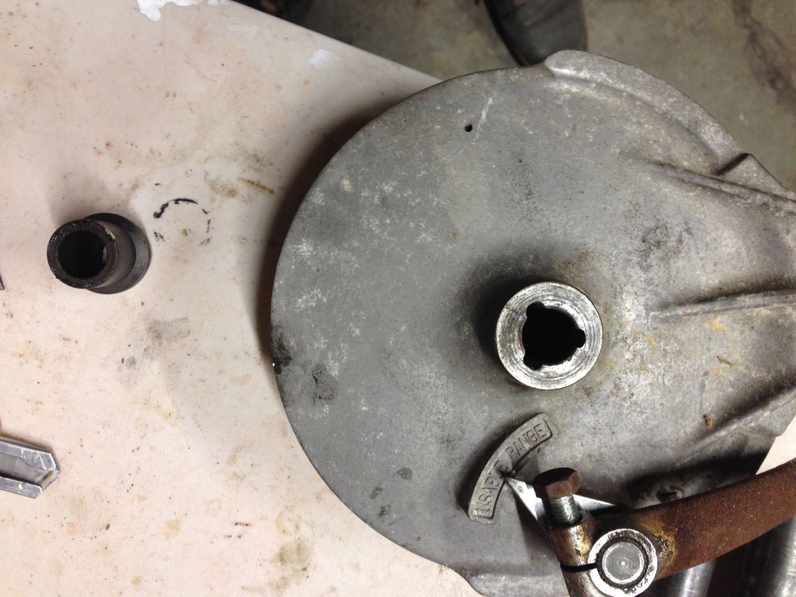

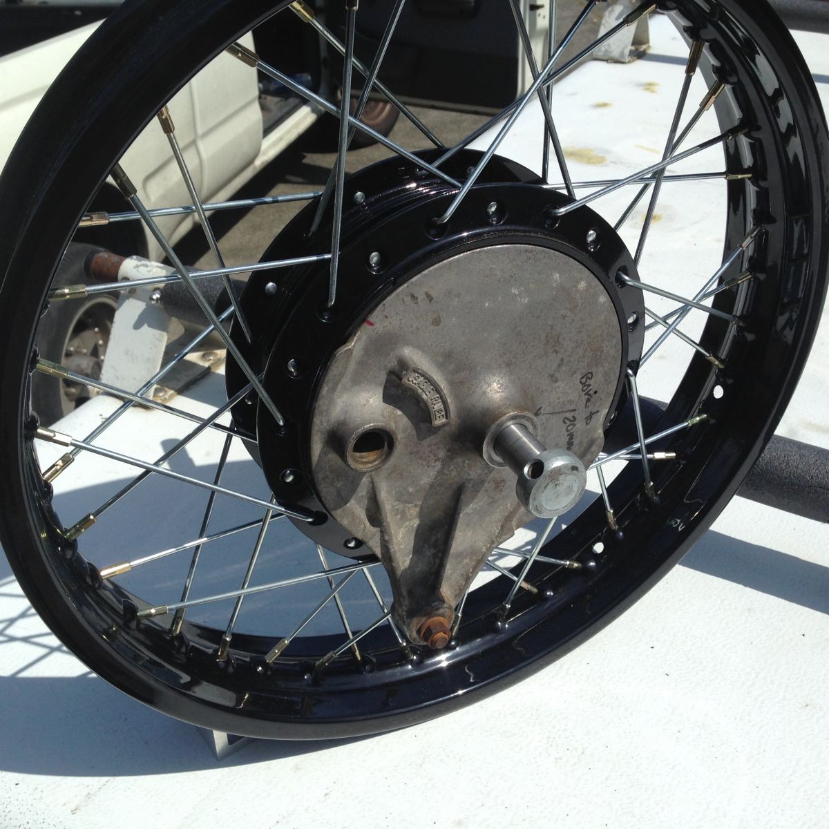

Done and done. had the machinst sleeve the brake plate with steel. came out perfect. still need to powder the plate though.

Gotta love it when a plan comes together...Congrats! A couple pics when its finished? Please!
