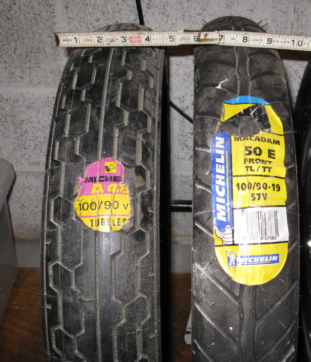

Long ago Michelin made an A48 (front) / M48 (rear) set of tires. I used several sets of them that were special ordered with PZ2 rubber compound and they stuck like glue. Of course, the rear tire only lasted 1,000 miles and the front only 2,000 miles; a lot of fun but I was going through way too many tires and $$$. Then I bought the same style (A48/M48) tires with normal street compound. They lasted much longer and offered excellent traction; not as great as PZ2 compound but very good.
Michelin stopped making that style tire years ago. So when I needed tires I bought Michelin Macadam (50E/50) tires. They did not offer nearly as much traction as the older style and were much skinnier than the older style even though I ordered the same size. Even the front tire would actually skid on dry pavement if I nailed the brake hard (scary in a panic stop situation); this had never happened before. Below is a picture of the Macadam and an A48 side by side for comparison; both are new front 100/90-19 tires,. The tread on the Macadam tires did not wear out as quickly as the older style BUT after about 4,500 miles my bike developed a high speed wobble. This wobble (very scary at 90 mph) was definitely caused by one or both of the Michelin tires even though the tread on both of them looked absolutely fine. After replacing a bunch of stuff on the bike trying to eliminate the wobble I replaced the tires (with Pirelli tires) and the wobble disappeared 100%.
I'll never buy another Michelin motorcycle tire. Ed
