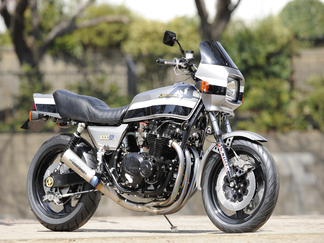

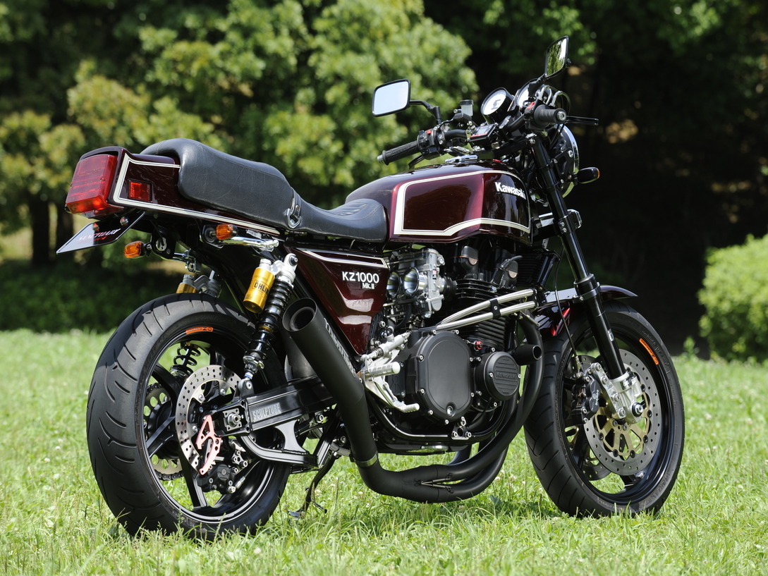

Here you go:
japan.webike.net/products/2067611.html
I haven't tried them out yet, just have them saved in my cart for the day I place an order.

Those won't even hit the ground before your stator cover is gone. Looks like the bike would have to be almost completely horizontal before touching.

What Doug said. They are formodern sport bikes where most of the components are tucked up and behind. They mostly protect expensive body panels and do and amazingly good job at it. I would think the small cage around the bottom of the engine type would suit a KZ 1k better.
