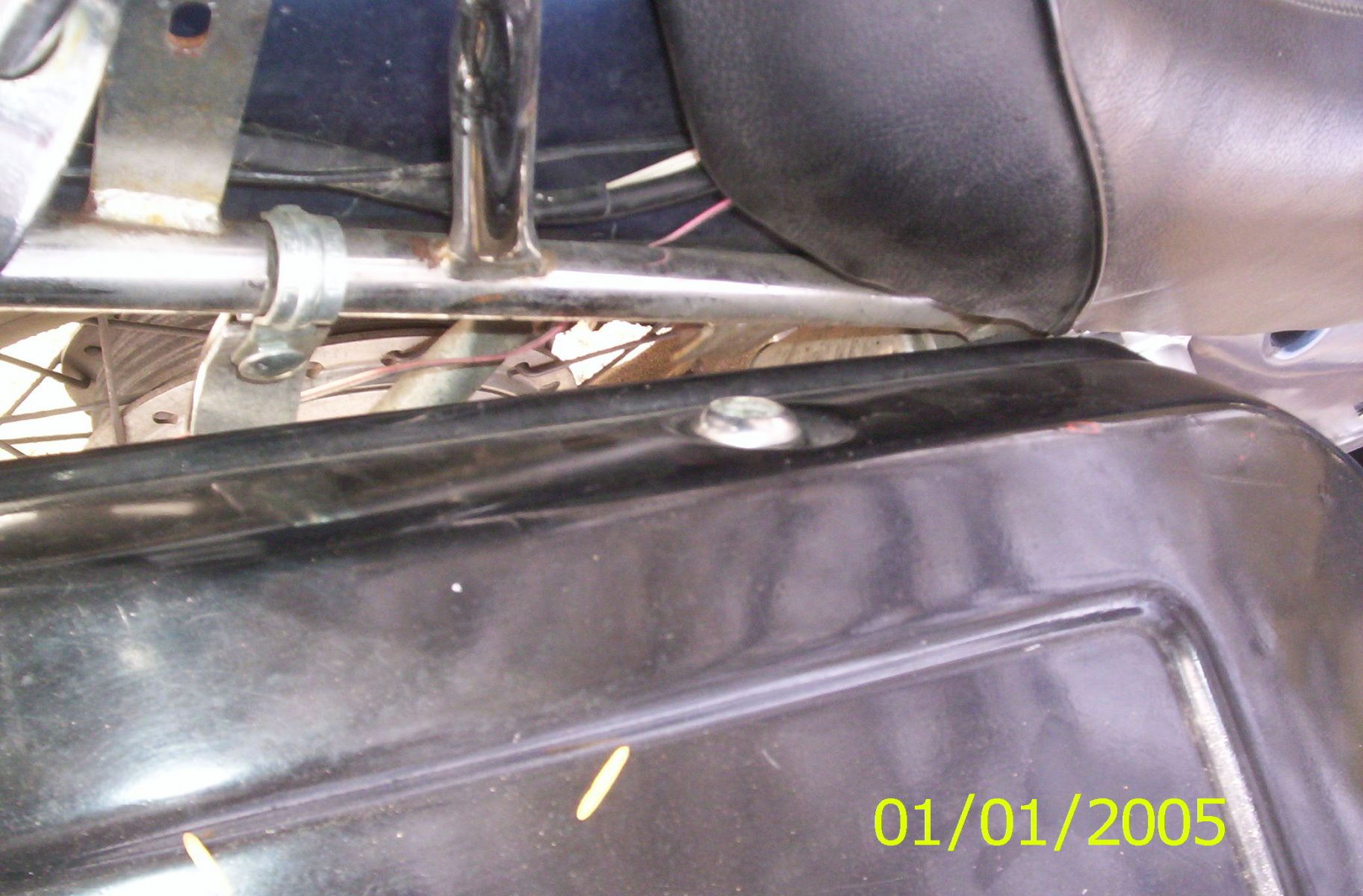

Back in the day a cheesy way to mount a rack or sissy bar on the Z1 was to use hose clamps on the grab bar but the rack was on an angle. Never liked it. I had a seat with sissy bar built in. You might consider fabbing something to your seat. This time around, I bought a new grab bar but when I picked up a rack off a old 350 Honda, it wouldn't work with it so I cut the tabs off the old one, welded them from the back, a little chrome paint and you can hardly tell with the top box and side boxes. Picked up a head rest from a junk yard for the back rest for $5. I'll post a pic later.

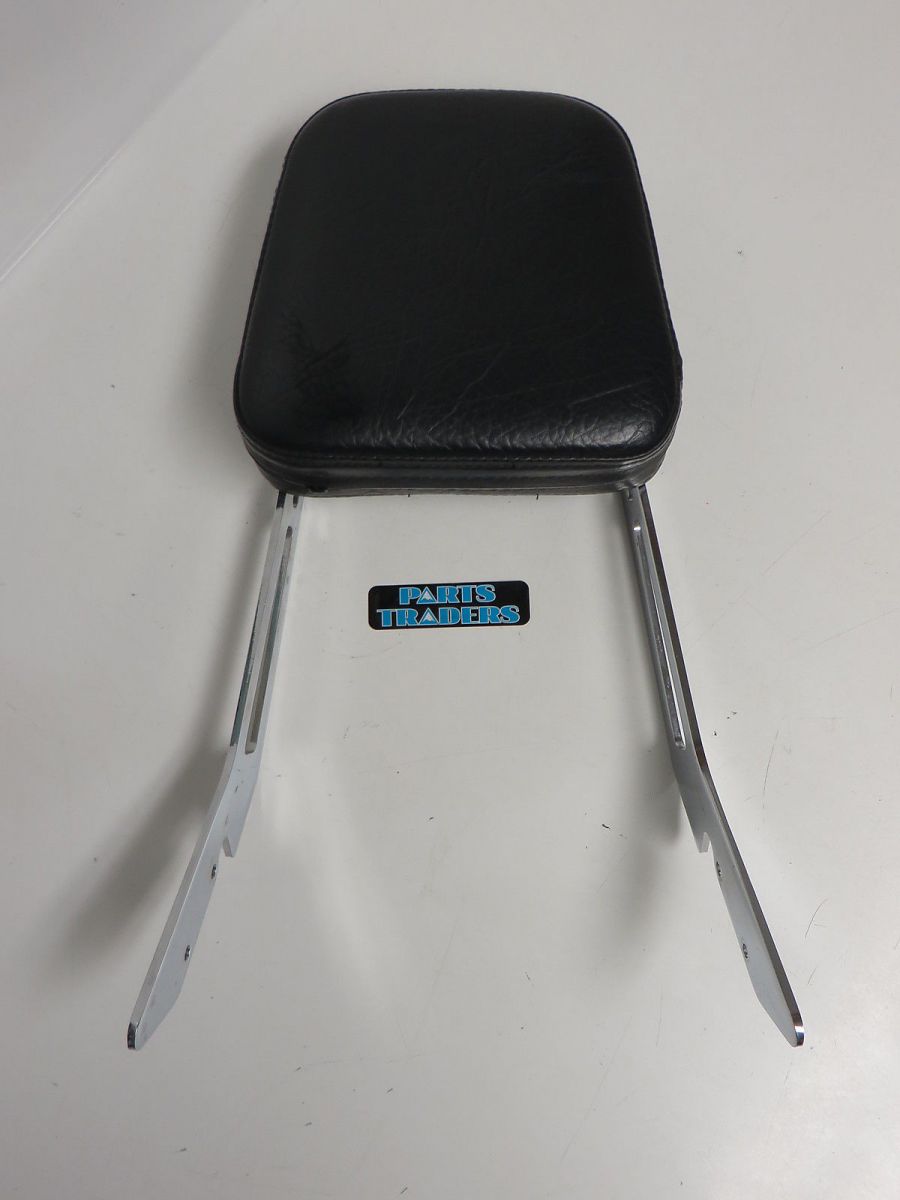

Here's something that might not be too hard to modify to fit a 550. You might just need to drill holes into each support arm plate, then add some spacers to make up the difference in width (assuming it's too wide). From searching eebbaayy for KZ sissy bar:
VINTAGE DETACHABLE SISSY BAR BACK REST - KAWASAKI Z1 KZ900 KZ1000 - M14101
NOS New Kawasaki KZ750 Sissy Bar Mount Plates K53033-021 K53033-021A
sissy bar Sissybar Aschco Vintage .
This one might flex to fit various bikes. Tape measure shown in some of the photos.

You can barely see the mount bushing past the lock on the box.
I was thinking something to bolt on to your seat like this.
