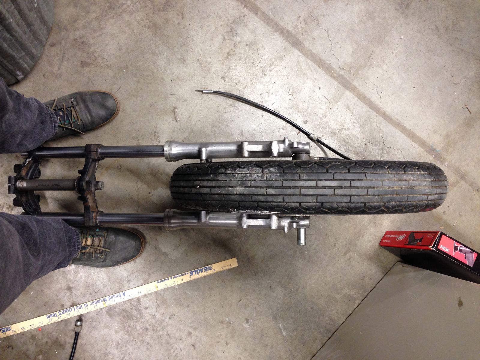

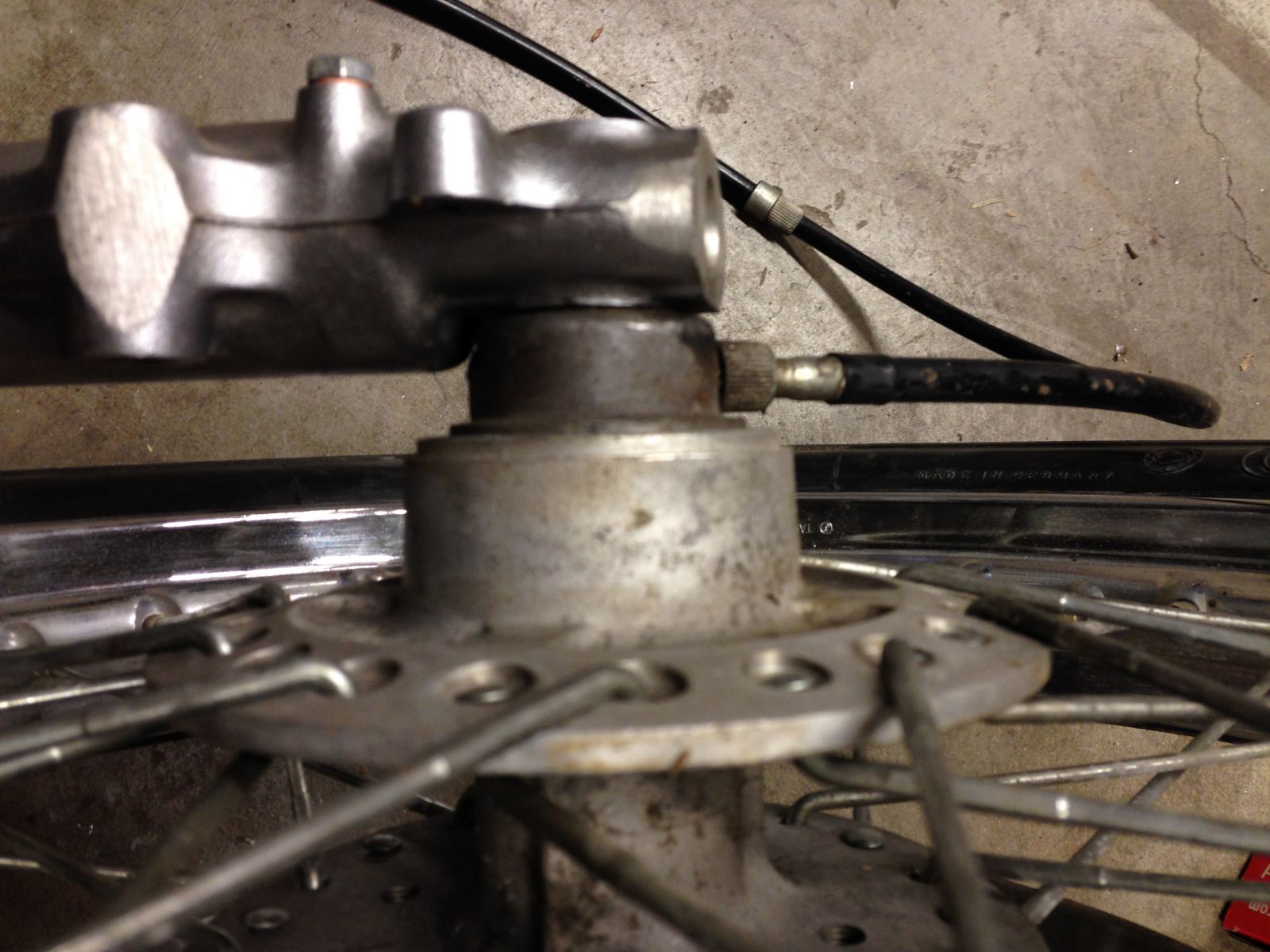

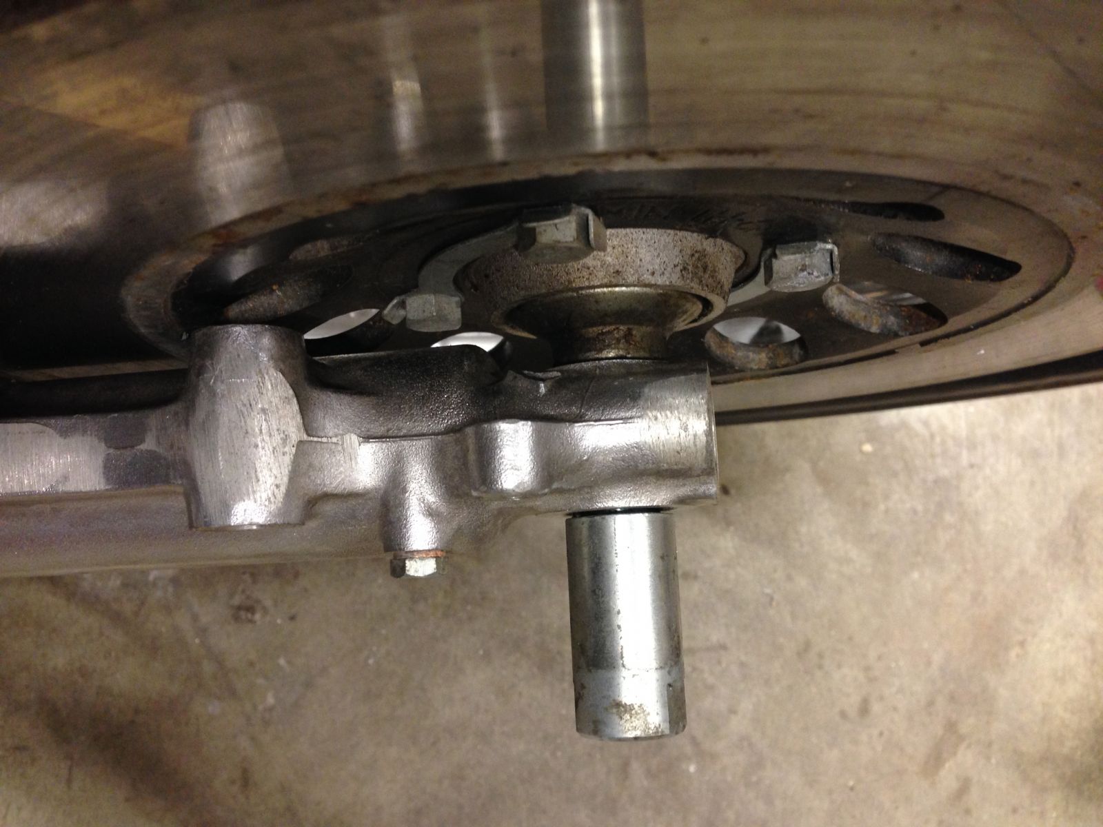

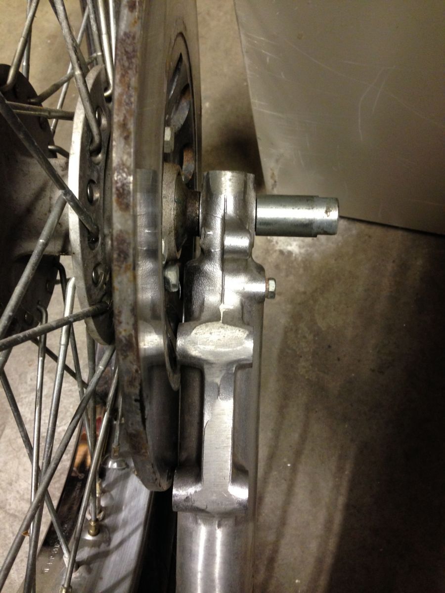

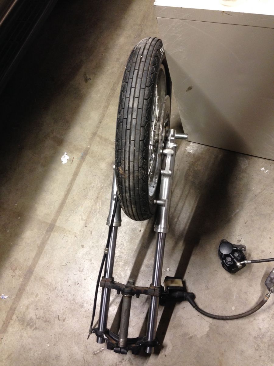

Rex, I got my 440 forks in the 400 trees and am trying to figure out how to get this to work. the 400 axle wont fit in the 440 fork, and It looks like you are using the 440 axle. Are you using 440 triple clamps too? as it sits the 400 clamps are too narrow to allow a brake to be mounted. there is 1/16th" on my setup between the disk and the fork tube; on yours it looks like you have a bit more room. what is the distance center to center of you fork tubes?

21 Mar 2015 08:06DoctoRot wrote: Rex, I got my 440 forks in the 400 trees and am trying to figure out how to get this to work. the 400 axle wont fit in the 440 fork, and It looks like you are using the 440 axle. Are you using 440 triple clamps too? as it sits the 400 clamps are too narrow to allow a brake to be mounted. there is 1/16th" on my setup between the disk and the fork tube; on yours it looks like you have a bit more room. what is the distance center to center of you fork tubes?
All my bikes with 33mm forks measure 5 3/4 in. between tubes.

- Nebr_Rex
- Posts: 1889
- Thanks: 295
Re: KZ 400 caliper swap?
21 Mar 2015 08:16
Your spacer on the disc side looks shorter.
Is the wheel centered between the forks?

- DoctoRot
- Posts: 2605
- Thanks: 766
21 Mar 2015 15:43
So my forks are the same width. The wheel is not centered in the forks however. it is closer on the disk side. but there is no extra room on the speedo side. Is it possible i have a different speedo drive?
