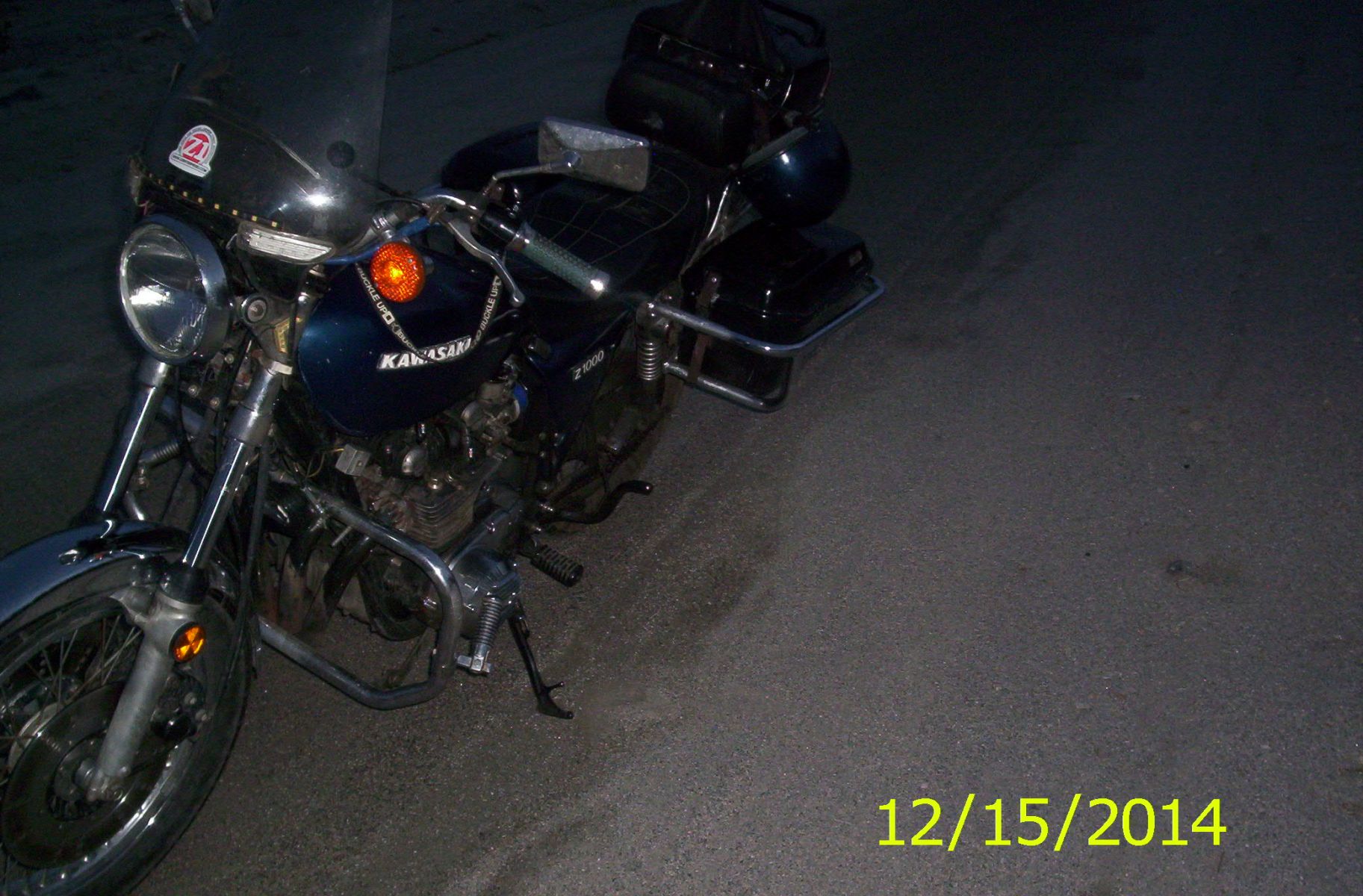

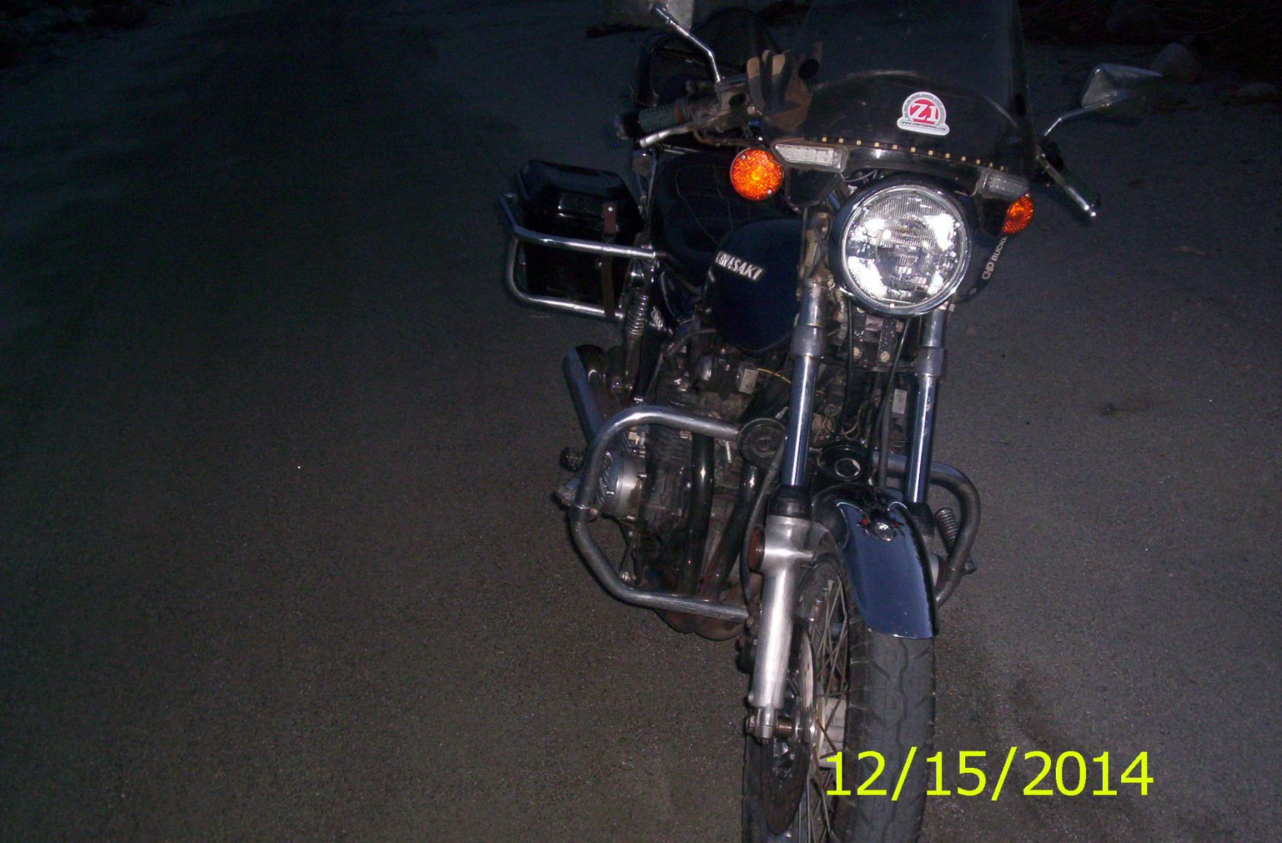

Thanks to Blake one of our members for the good deal on his KZP box guards. The police boxes are narrower than my 75 Amco aftermarket boxes. The mounting was lower as well. It took some doing and by using that ugly wrap around monstrosity that tied everything together, I cut, switched mounts and made spacers using what I had on hand. I'm not done yet but they work. I still need to make a bracket to go under the tail fin to connect the two boxes together. They're OK as they are but I want a little more rigidity. Shouldn't be able to see it if I do it right.
Only one problem, splitting lanes will be tougher.
