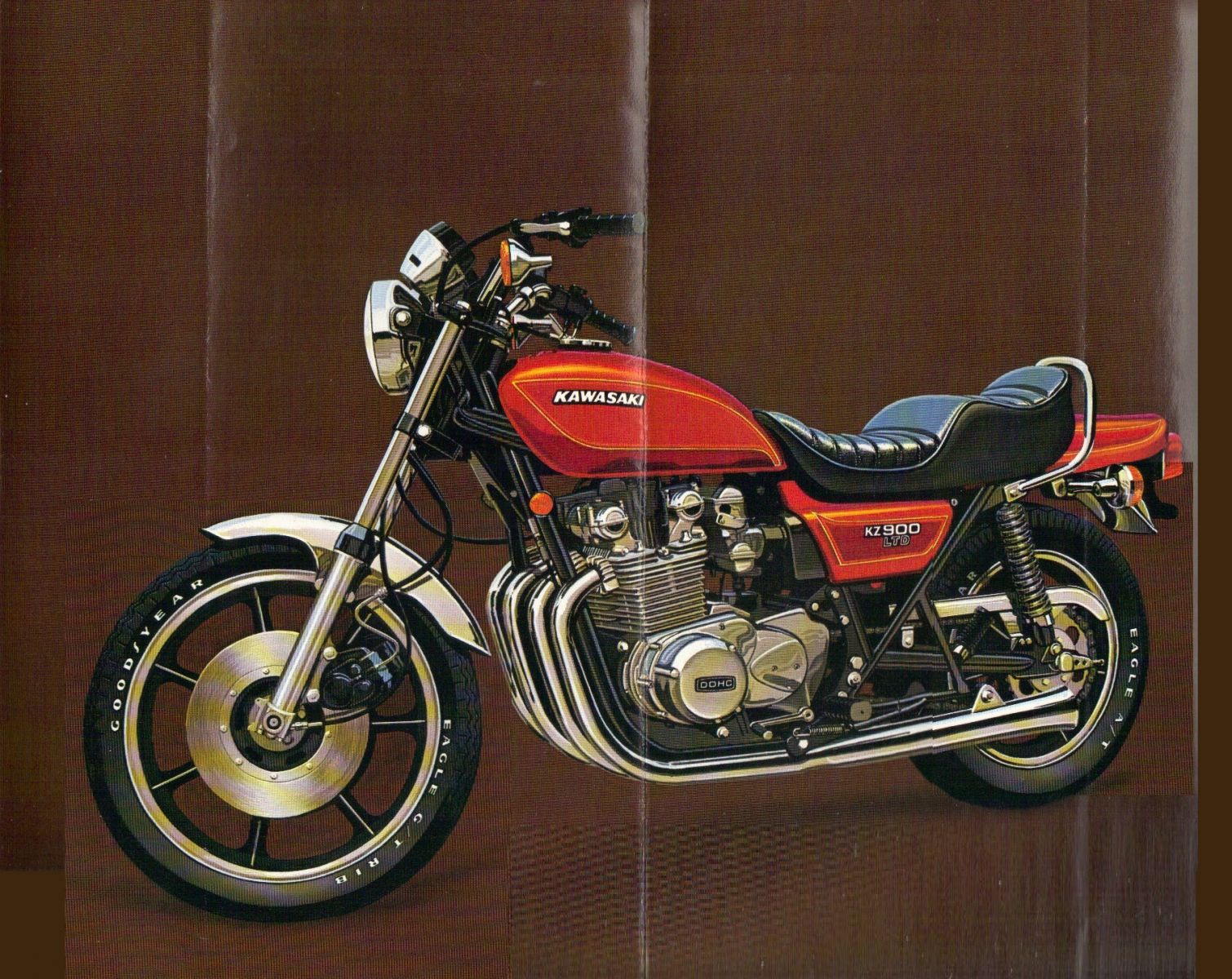

KZ900 standard model came with 18" spoke rear wheel and drum brake.
KZ900 LTD model came with 16" Morris Mag rear wheel and disc brake.
If wheels are genuine Morris Mags (as factory equipped on KZ900 LTD), would think twice about tossing them, as they are quite valuable and desirable items.
