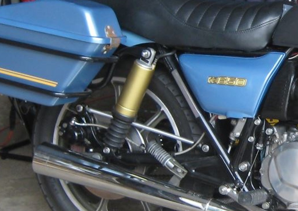

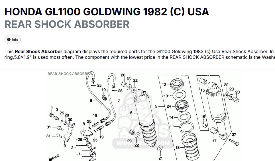

29 Dec 2025 13:25 - 29 Dec 2025 13:31Those Showa air shocks from the 1980's bikes were used on a lot of makes/models. There are a lot more examples out there of others rebuilding them for Honda Gold Wings and Harley Road Glides.Hello - did you ever find a place that had seals/rebuiild kit or information for your air shocks? I have a 1983 Kz-550 spectre - which has basically the same air shocks as your 750 - and the rear shocks have started leaking/not holding air pressure. OEM shocks from ebay, Partzilla, Kawa parts nation and other places are impossible to find. Might have to turn to aftermarket shocks.
On the Honda bikes they show a complete tear down and parts list.
I have a pair of Spectre 750 shocks that need a rebuild someday but have not looked into it too hard yet. I did capture some old documentation of a rebuild with pictures and the part numbers check out.
Honda are pretty good at keeping up on spare parts so most of that stuff is still available to order.
1978 KZ650B2 modified project
Last edit: 29 Dec 2025 13:31 by Injected. Reason: pic

Re: Rear air shocks
29 Dec 2025 13:51
Yep, those on the 650 look just like mine. I will check out the Honda GW parts list and see what the dimensions are. Thanks for the info!

Re: Rear air shocks
30 Dec 2025 08:27 - 30 Dec 2025 08:30The main oil seal (#24) is listed as 33 x 66 x 10.5 mmYep, those on the 650 look just like mine. I will check out the Honda GW parts list and see what the dimensions are. Thanks for the info!
