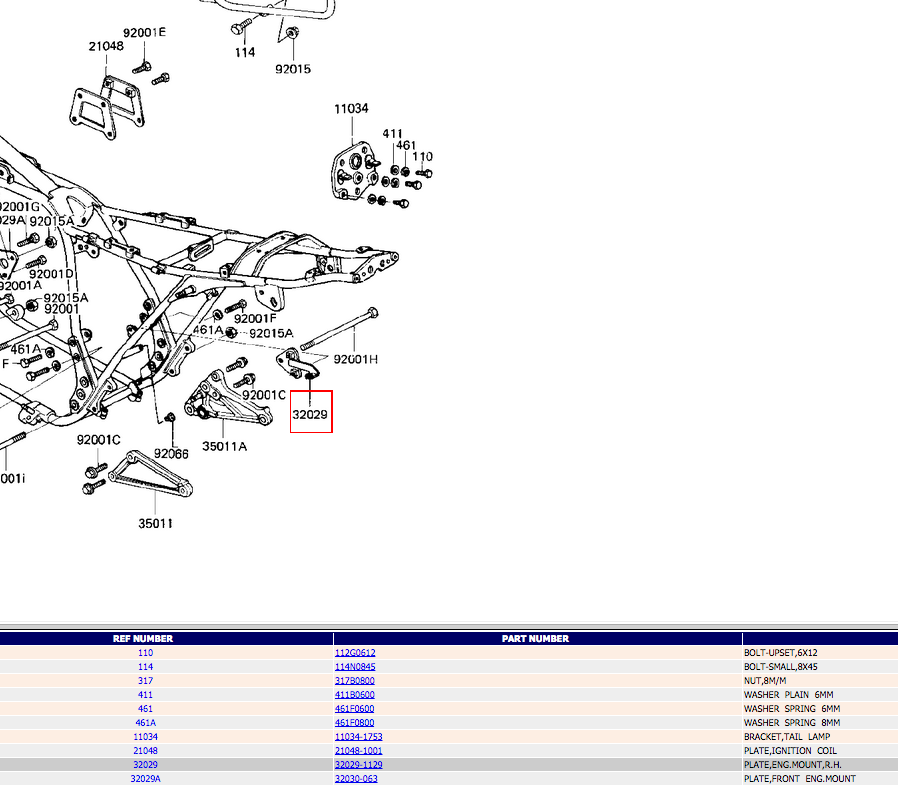

According to the Kawasaki site the 750E and 750H share most of the motor mounts and hardware with the 650A, B, C, and D. The rear right motor mount Is not the same on the parts diagrams. However, because the left one fits both the 650 and the 750 the mount likely will line up fine on your 750. It appears there is some type of bracket added to the plate that caused it to be exclusive to the 750.

Thanks DoctoRot !! That leads me to believe that there the same part / engine guards, for both bikes. That's what I wanted to know.
