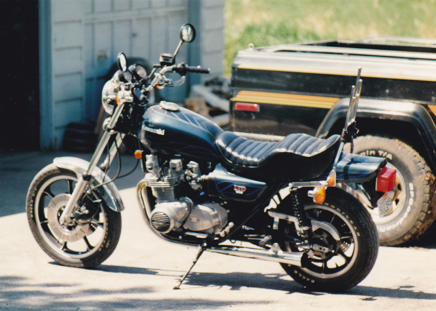

11 Aug 2014 10:29
When I bought my bike in 82, the P.O. had 4-6 inch extended forks on it, tried to make it look like a chopper, I switched back to stock forks as soon as I could, but the kickstand was about 2-3 inches longer than stock & would easily tip over when on the side stand, so I heated it up bent it out some & bent the toe down ,to be flat with the pavement ...Perfect !!
